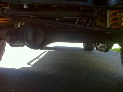

Pic for reference. Anything look odd from pic?
a80crewza
Posts: 301
Joined: Wed Jan 09, 2013 1:54 pm
Re: Do I need a steering damper? 80 Series
Post by a80crewza »
Okay an update, got a wheel alignment done today.
Castor before bushes were in: Left > -1.41, Right > -1.30
Castor after bushes: Left > +3.12, Right > +3.17
If stock is meant to be +3.00, would have thought my castor is now OK?
Diff offset is fine I think, its the same measurement on both sides from the wheel sidewall to the chassis.
Return to “Toyota”
