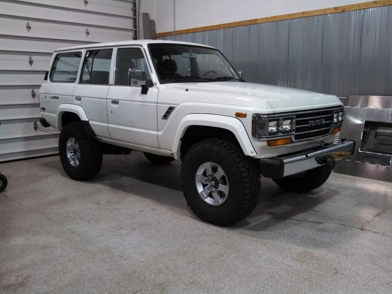

Wanting to know thoughts etc about putting a 60 series body on an 80 series chassis. I love the look of the 60 more than any other, but wanted the refinement and comfort of the 80, coils, 1hdt etc. Anybody ever heard of anyone doing this or is it a stupid idea :roll:

Going for this look: http://www.blogcdn.com/www.autoblog.com ... rns-60.jpg
Whats the deal with modifying or adding body mounts to the chassis in terms of certing etc.

It always pays to talk to a Certifier first as when I did my truck he really wanted the gussets coming from the new mount to the chassis to be the full height of the chassis.Welding to the chassis is not a problem.
