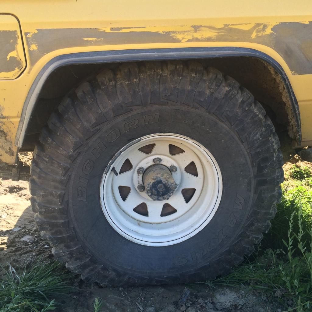

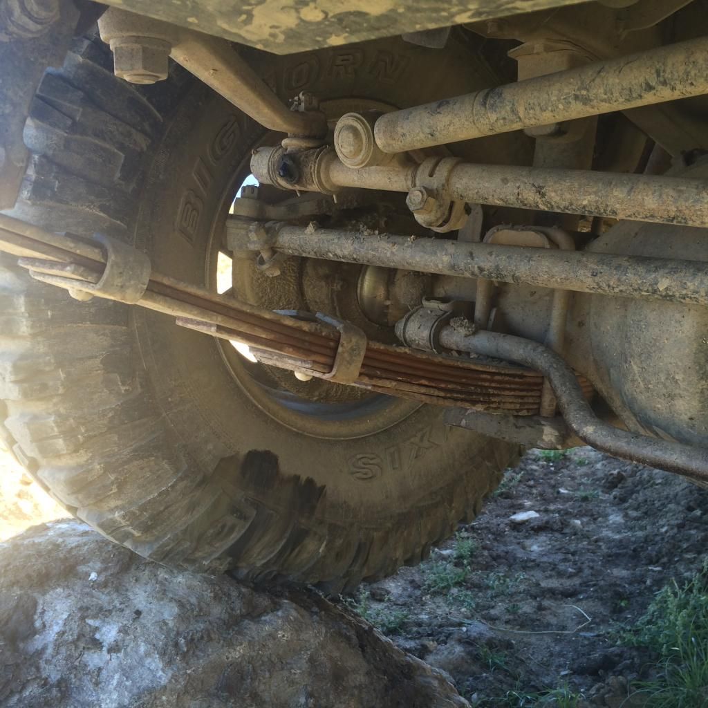

Heres some pics to show flex, not huge but does the job for now, could probably get some more out of it but it was the biggest rock i could find haha.

if you want to start getting some big flex under it you'd probably want to start looking at a mwb shortys can get a bit hairy and tippy you want something with a bit more wheelbase to keep it more stable (imo) when you've got wheels flopping up and down all over the place you end up with rapid weight transfer from front to back or side to side which often means "flop" if it happens too fast and when your not expecting it :D , if you want to stay leaf springs you need the longest springs you can get in there with a relatively flat (ie not vertical) shackle angle to give a big shackle travel arc to let the suspension open right up, cool offroad but outright scary onroad with the amount of body roll and definitely a lot harder keeping it legal and safe if its used on the road as well :D good performance offroad = worse performance onroad :D if your going to go do all that work with leaf springs you might as well put the time, energy and money into 3 or 4 linking it or selling it and buying what you want it usually always works out cheeper :D

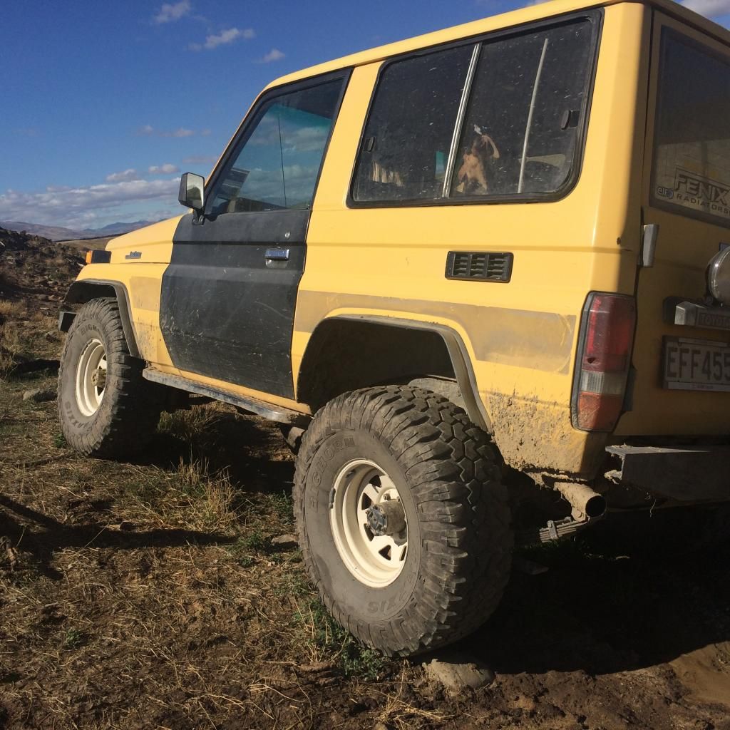

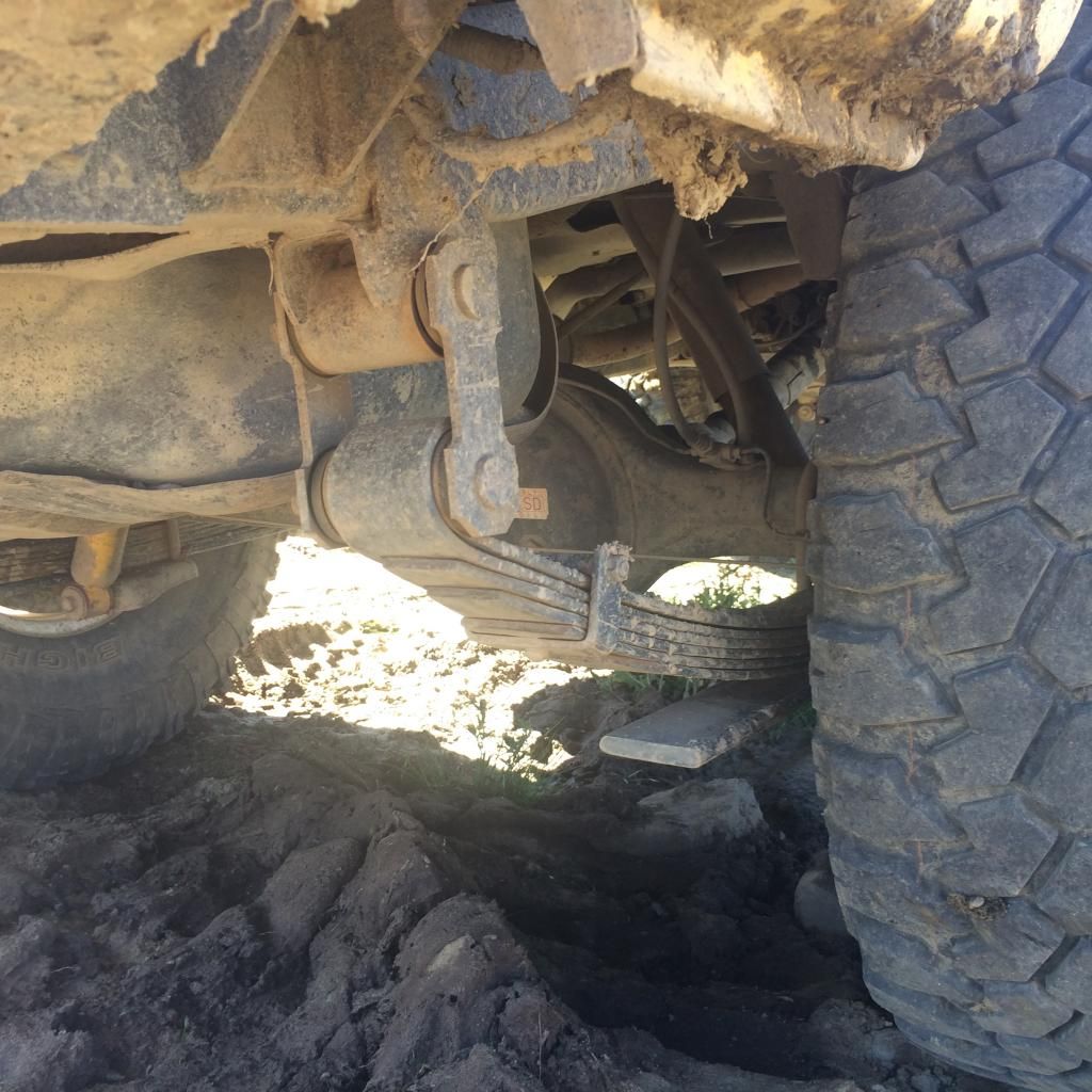

so theres my new one, some small boots on her but like i said, wanting to fit 35"s under there, looks like theres heaps of clearance so could maybe fit 35"s under. Mates just switched his 74 series springs for new 2" ones and hes sitting at the same height as before fully clearing 33"S so yeah haha
think i might start with just 2" lifted springs and then see how things roll

here's mine before and now was on sagged to factory height lift springs super soft allways on bump stops slight rub while flexing preformed really well,31's 35's now 37's
