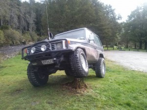

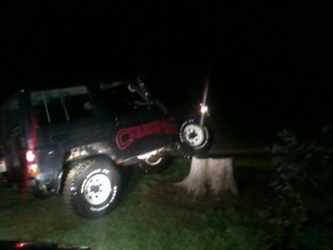

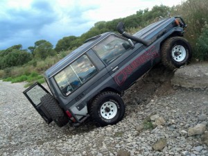

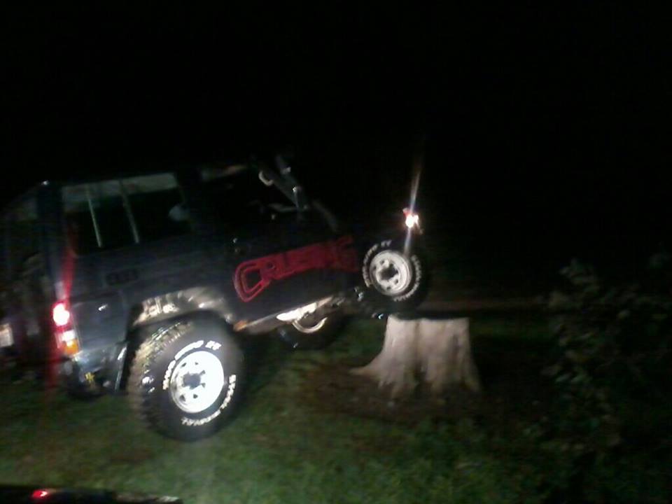

terrano
Posts: 151
Joined: Mon Dec 24, 2012 5:01 pm
Location: Central Otago
Re: A couple of fj70 questions
Post by terrano »
Heres some pics to show flex, not huge but does the job for now, could probably get some more out of it but it was the biggest rock i could find haha.

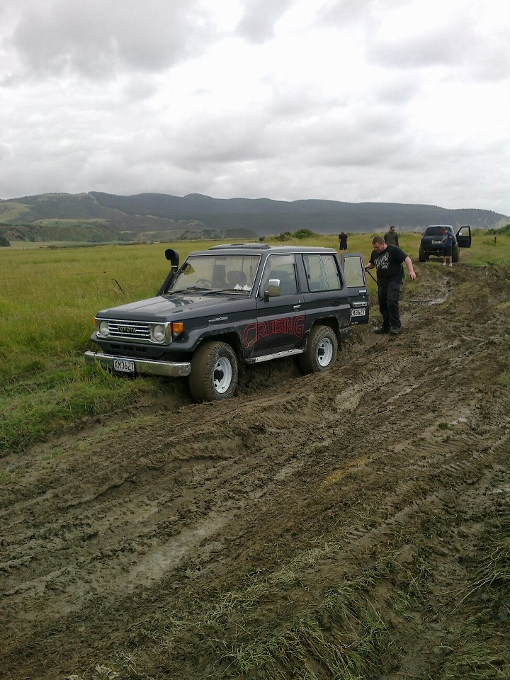

so theres my new one, some small boots on her but like i said, wanting to fit 35"s under there, looks like theres heaps of clearance so could maybe fit 35"s under. Mates just switched his 74 series springs for new 2" ones and hes sitting at the same height as before fully clearing 33"S so yeah haha
think i might start with just 2" lifted springs and then see how things roll

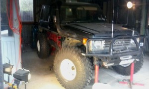

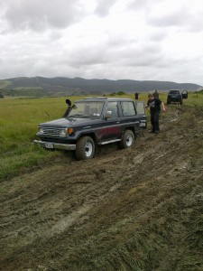

The WEHI
Posts: 387
Post by The WEHI »
here's mine before and now was on sagged to factory height lift springs super soft allways on bump stops slight rub while flexing preformed really well,31's 35's now 37's
