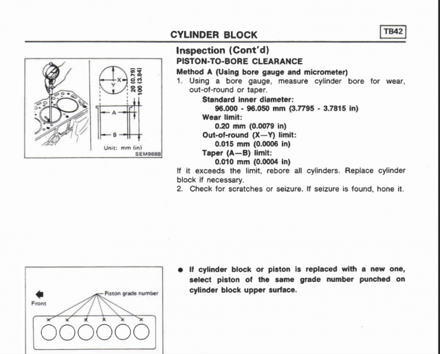

yes it is, the liners are quite thick, mine doesn't run hot at all unlike my 0.20 oversize Cleveland 351 did.
its miro balanced engine, clutch, flywheel, the whole assy was done, spins loverly
https://drive.google.com/folderview?id= ... =drive_web

Hi, The thread title is TD42, the page you posted is for a TB42.
Here is the same page from the TD42 Engine Section of the manual, replacing the liner is mentioned twice on that page and re boring is not although I have seen elsewhere where the parent bores can go out of round and need to be bored out and sleeved prior to inserting a standard liner.
