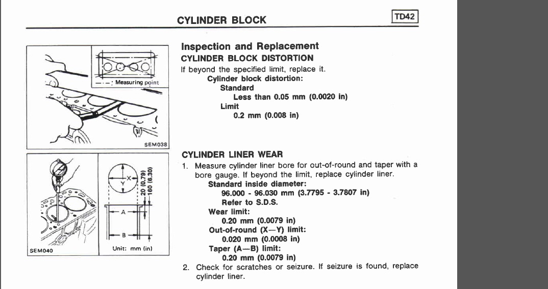

Hi, The thread title is TD42, the page you posted is for a TB42.
Here is the same page from the TD42 Engine Section of the manual, replacing the liner is mentioned twice on that page and re boring is not although I have seen elsewhere where the parent bores can go out of round and need to be bored out and sleeved prior to inserting a standard liner.
