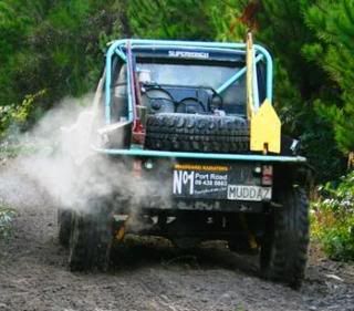

And colder the better as far as the coolant goes. The turbo will be heating the air so you want to cool it as much as possible. I've mounted the radiator on the deck of my truck but it is quite a bit bigger than a subbie one. ie it has twin fans and is out of a 2 litre car.
You can see the top half of the rad above the spare tyre.

Re: Intercooler options for a gq (4.2 diesel just been turboed)
what core did you use darinz? is it custom or barrell etc
PWR 6x10 barrell
