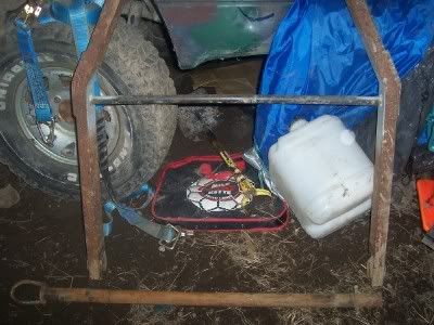

the scudos are pretty weak for hooks , i made my basic bar and welded it on then made a bit for the hook , mine is back so i dont dig into banks, it is all behind where the std bumper would be , heath the a frame through the tube works well and they a frame well,untill you lock the diff :D , now it tows like a pig. vaughan

The A frame you have is bloody close to the picture I drew but I was going to use seperate pins on each side not just one long bar. How long over all is your frame (guesstimate will do)?

mine is about 1700 overall, it is quite long but it used to tow really well and you could tow it anywhere on gravel or seal and it would follow with no weaving,

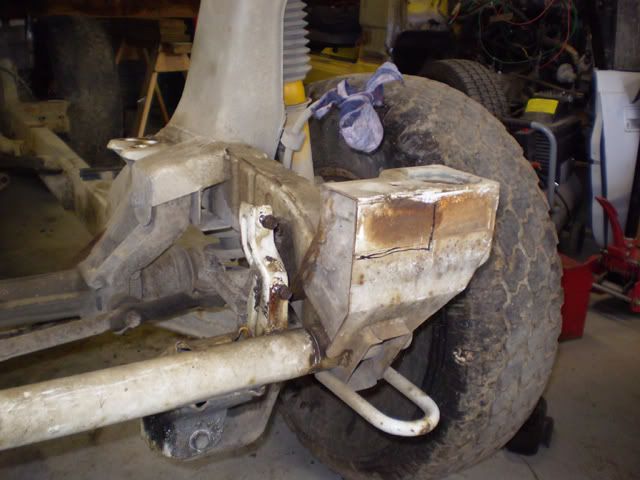

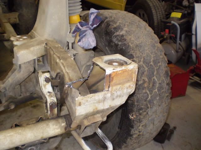

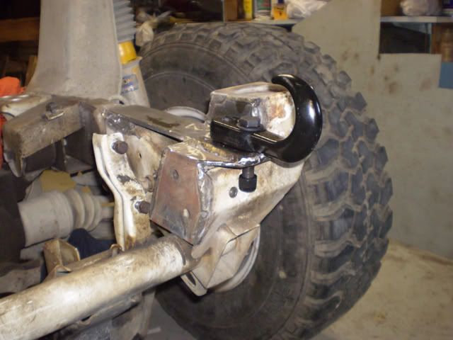

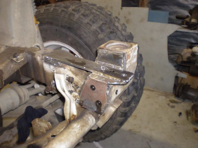

Finally found the pic's of the tow hooks I put on my cousins vitara . Now what I have done will have to be argued with the scrutineers as to weather what I have cut is chassis or not , but it was the best way i could find to do it . They are high and well recesed , possible the most you could go .
I have assumed the piece I cut is body mount not chassis but since this will probably not get rallied was not too concerned .
cut along the dots :D
Now a 5mm angle was cut to the shape of the recess and protuding for the mount out of a bit of 70mm x 50mm . Two nuts mounted on the inside for a bullbar mount and one on the top for the tow hook . Prior to welding up a plate of 5mm with a nut of it was welled inside of the front face for bullbar mounts , seen below the hook in the hook on pic .
Then for good measure a 5mm plate was welded on top and taken back to the chassis , this does not interfere with any of the body work and runs nicely under the steering box . The side of the body mount was filled in and hook bolted on and that was it .

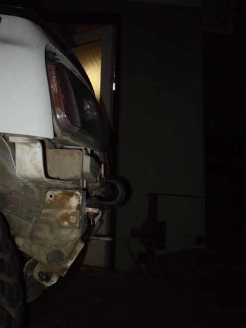

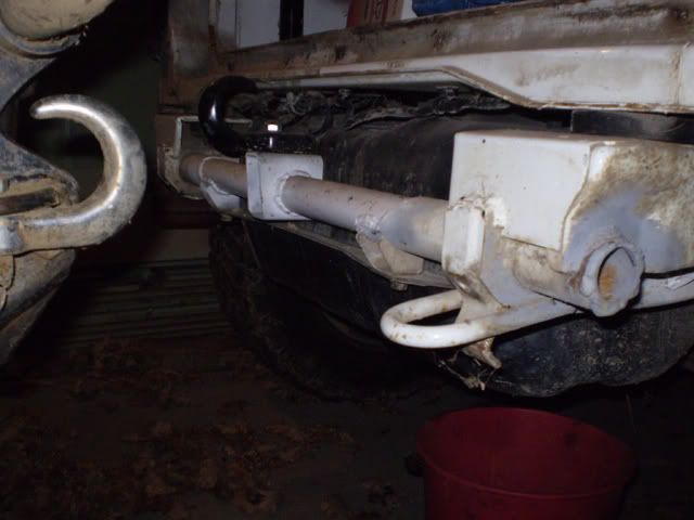

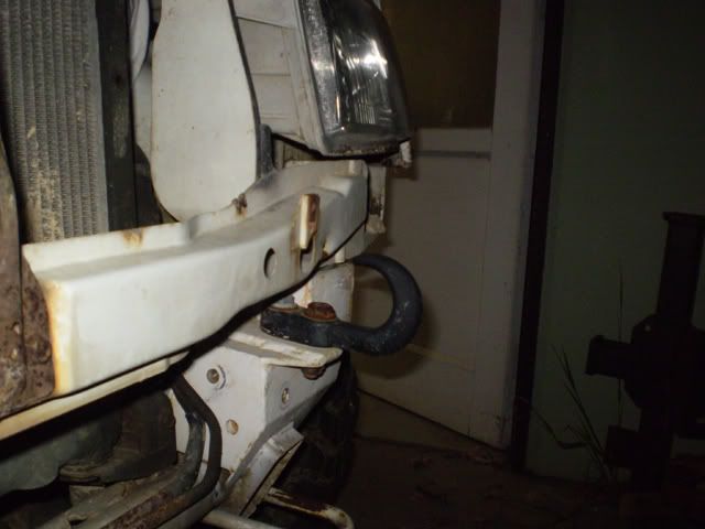

For the rear i cut out the last chassis cross member and slid a piece of 32NB heavy wall pipe inside it but passed it through a box section with a hole cut in the side of it and mounted the hook on this , to be legal for a rally you would need to cut the removed crossmenber and weld it back under the pipe . Will see if I can get a pic .
Ok its a bit dark outside but you get the idea .
Also here is the front in profile , see the hooks are about as far forward as the factory to hook :D
I suspect this is all to late but never mind some one may get some ideas from it .
