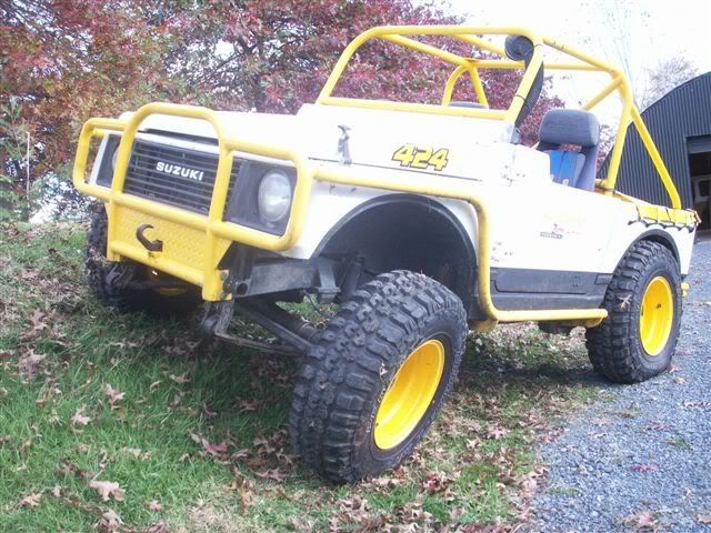

I have the 31s on my 413. So far they arent too bad. Bang per buck they are really good, got mine very cheap through mate at tyre shop. First outing on them was extremely greasy clay based conditions, they struggled a lot as did most so was hard too gauge how they performed. Next comp is at weekend after next if your keen too come down have a look and make your own thoughts about them. Not sure on MrOs bagging comment. They are 3 ply where pirelli, hankooks etc are 2 ply hence they will bag "easier" Im running 4 psi in rear and about 6 psi at front and should really drop another 2 psi, but have too be careful of beads then
good sized voids between knobs. Rear is bagging in that pic but should look like that on level
