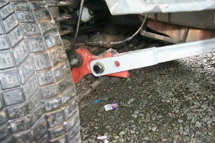

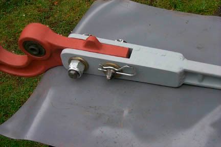

Not sure if it would be allowed here but could be applied to any coil spring front end with radius arms.
Full story here
91Rangie wrote:Came across this idea while surfing around just wondered what others think of this idea.
Full story here
NJV6 wrote:The diff should be held in place by the radius arm on the other side.
Essentially all this is doing is the same as pulling one bolt out of the radius arm mount at the diff end as one of the pic's of shane's shows on the X link thread.
