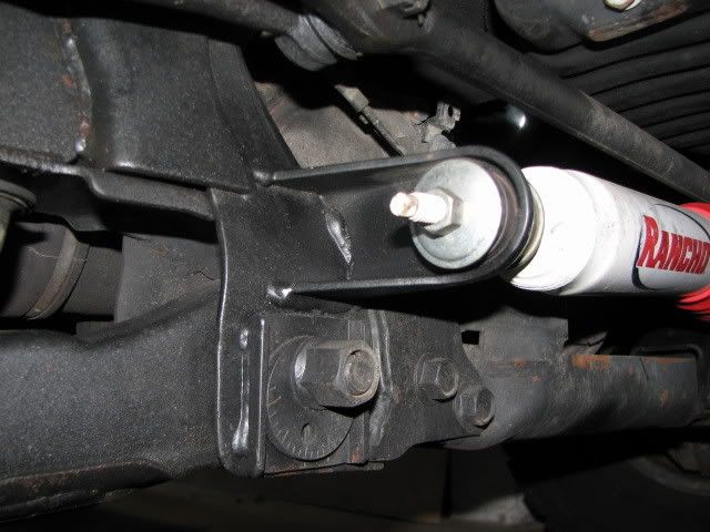

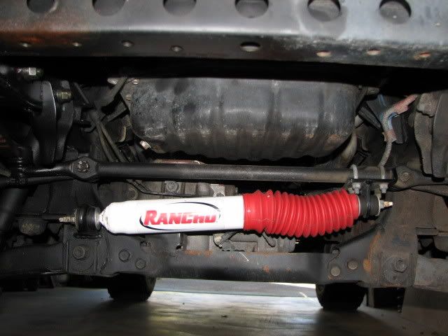

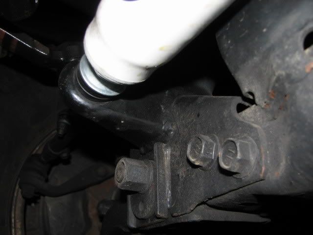

Your in palmy? if so come round and have a look at my set up, it is welded to chassis then has a ubolt clamping it to the steering rod
