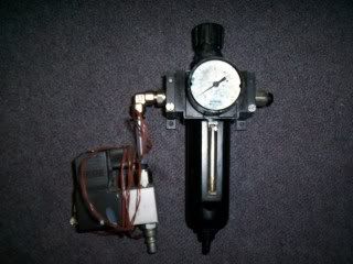

rangimotors
Posts: 1631
Location: chch
Re: pressurising diffs and gearbox
Post by rangimotors »
One of these would do the job..
But i have some of these as well, with a water trap, gauge, regulator and that thing on the left is a 24volt valve so we can hook it to a switch to turn it on and off if ya want?

Post by zookfest »
sweet as dave keen as on the second one with 24volt as the truck is 24

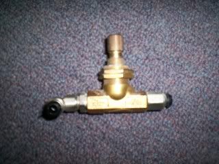

fweddy
Posts: 1062
Location: North Canterbury
Post by fweddy »
vvega
Posts: 972
Location: hamilton
Post by vvega »
thats a sweet little unit :D
