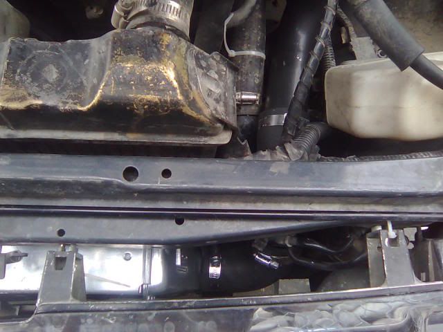

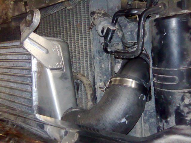

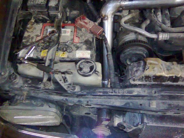

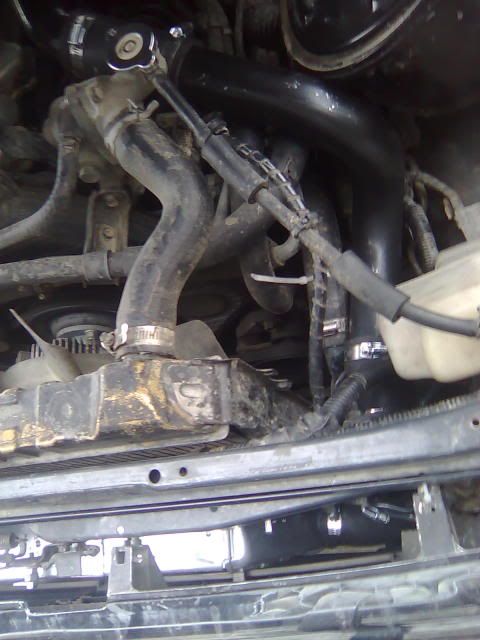

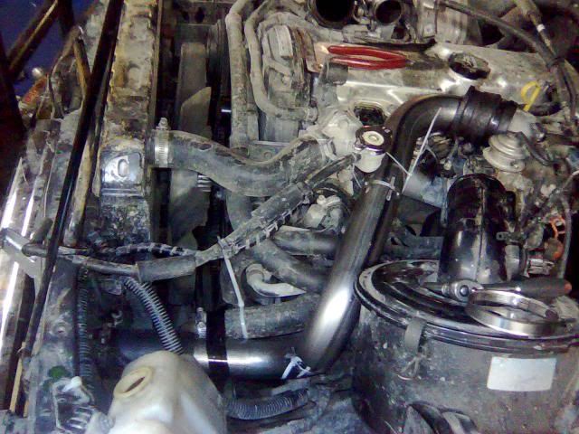

Inter cooler in poisition
Existing hole has been opened up slightly

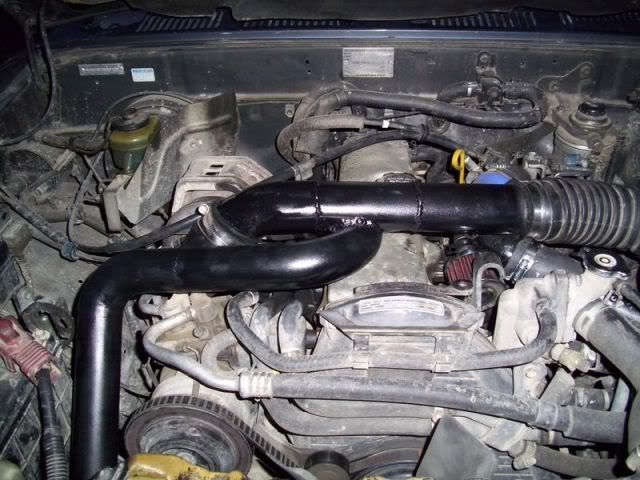

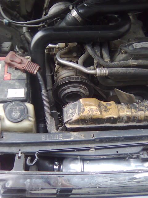

Turbo side Piping tac welded
Turbo side Piping Test fitted

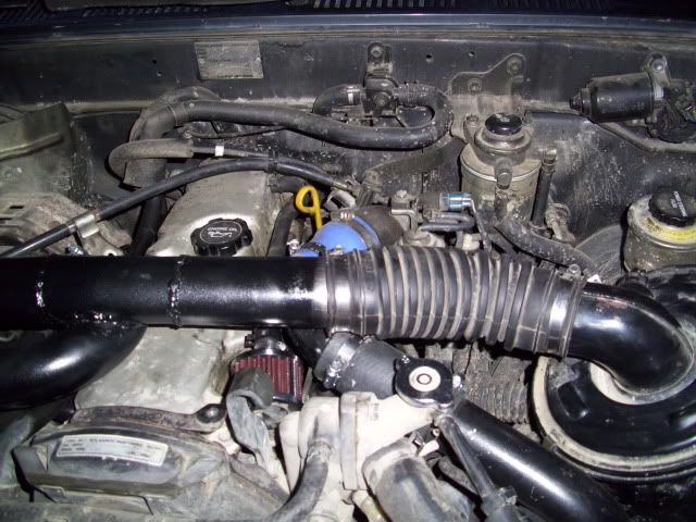

I still need to create a hole for the for the Intake side piping and make brackets for the bonnet latch support and to fix the inter cooler in position
I am also not sure how i will do the Air Filter/Snorkel Piping, I am considering using a larger diameter pipe and having it pressed into an ovel shape to allow enough clearance for everything to shut.
With the addition of a Pyro and Boost gauge I should be able to increase boost to 11 or 12 psi and have any fueling adjustments made.
