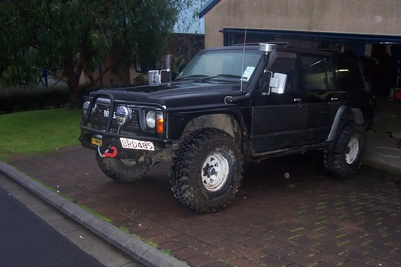

i ran 33" tyres on my non turbo patrol for years as I thought I needed a turbo to drive bigger tyres. I then bought a set of 35x12.5 simex (which meassure 35.9", same size as my 36" Super swampers). I wish I had gone straight to the bigger tyres to start with. In low box you have more than enough torque to drive the 36" tyres and there is little to no difference on decents between the 33" and 36" tyres. It transformed the capibility of my Patrol. Just do it, you won't regret it.
I run 2" suspension and 2" body lift with slightly trimmed guards and extended rear bump stops; so 4" and 2" on yours will be fine.
The bigger tyres look better too.
