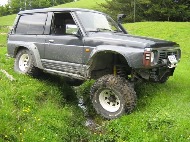

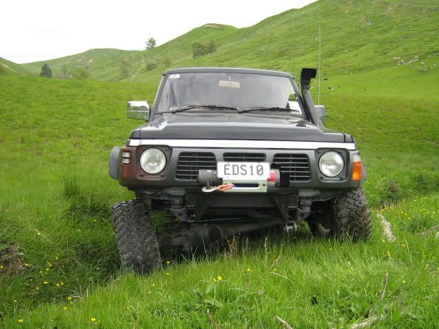

Just installed a Superior Engineering flex arm with OME 80 series LC shocks and radius arm spacer/washers.
Primary reason for installing it was to free up the front articulation so it better matched the rear enabling the truck to stay more level. The 80 series shocks are 30% longer and the extra articulation is noticeable. The truck is much much more stable. No major difference in road manners.
Not cheap - about $ 800 NZ incl freight and GST but money well spent.
Cant wait to put the 35" Simmy's on and really try it out
Thanks DaveM for pointing me in the right direction as it is definitely a better option than the XLink for what I want
