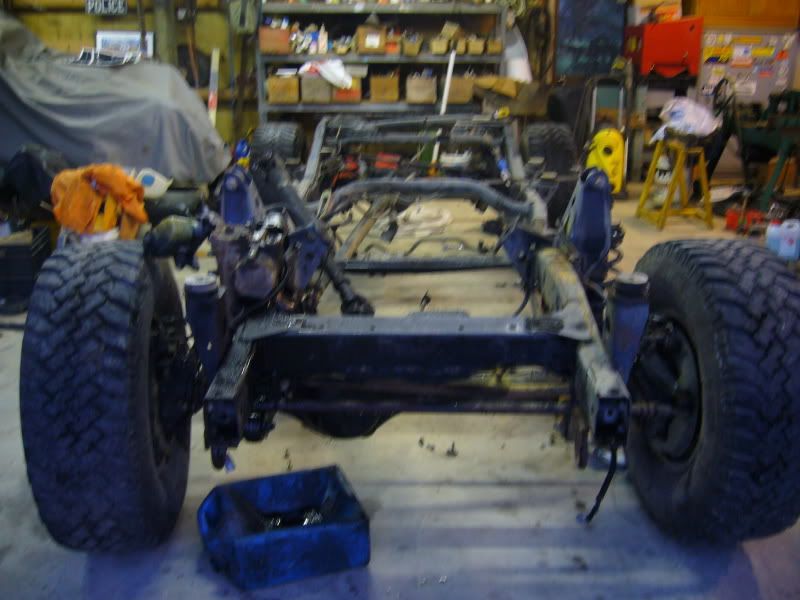

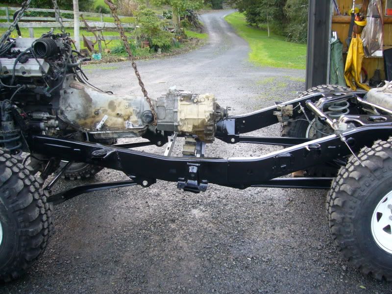

Toyota Prado 1995 LWB Chassis and diffs
The body was soon removed
We sat the body onto the new chassis to work out where all the new mounts would be needed.

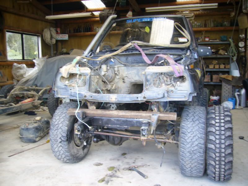

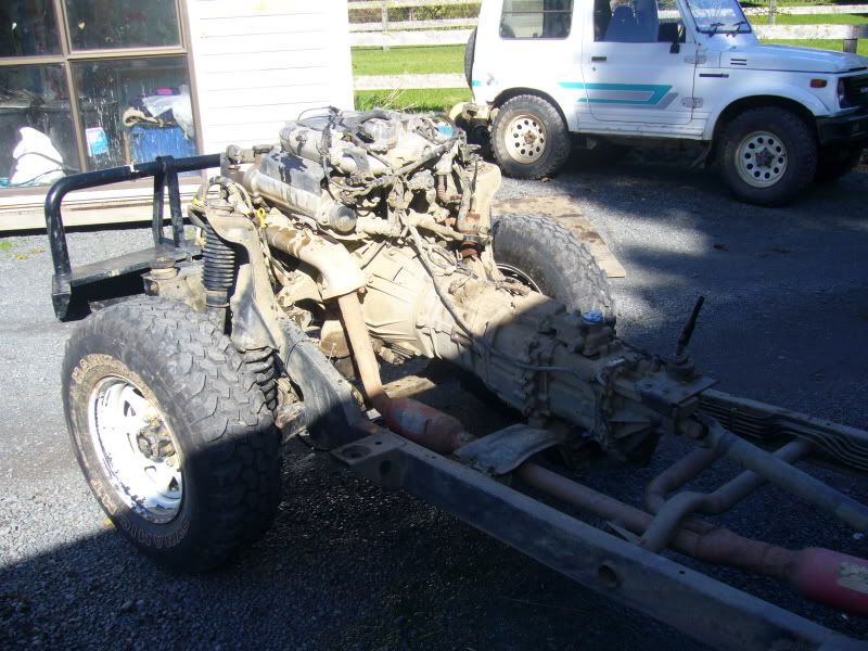

Chassis was shortened at the front middle and back.

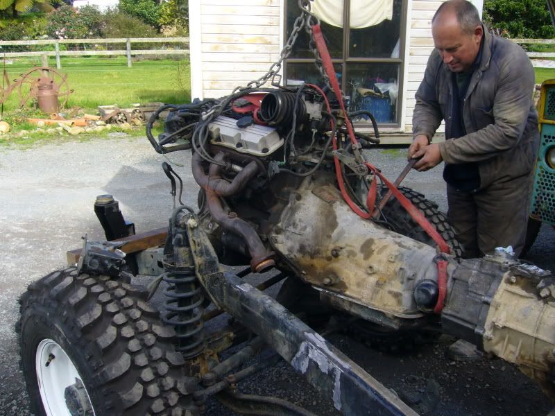

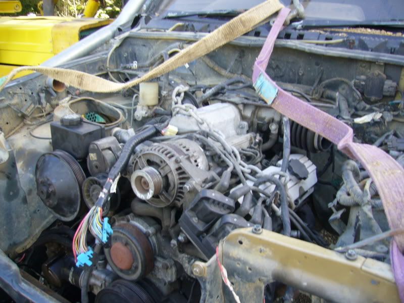

Holden Commodore 3.8L VN V6 motor running the 4 speed auto with an adapter plate to bolt to a Toyota surf transfer case.
The motor was lifted onto the chassis then the body lifted over top to work out where the motor needed to sit.

With the motor now in place, the body was removed for the final time.

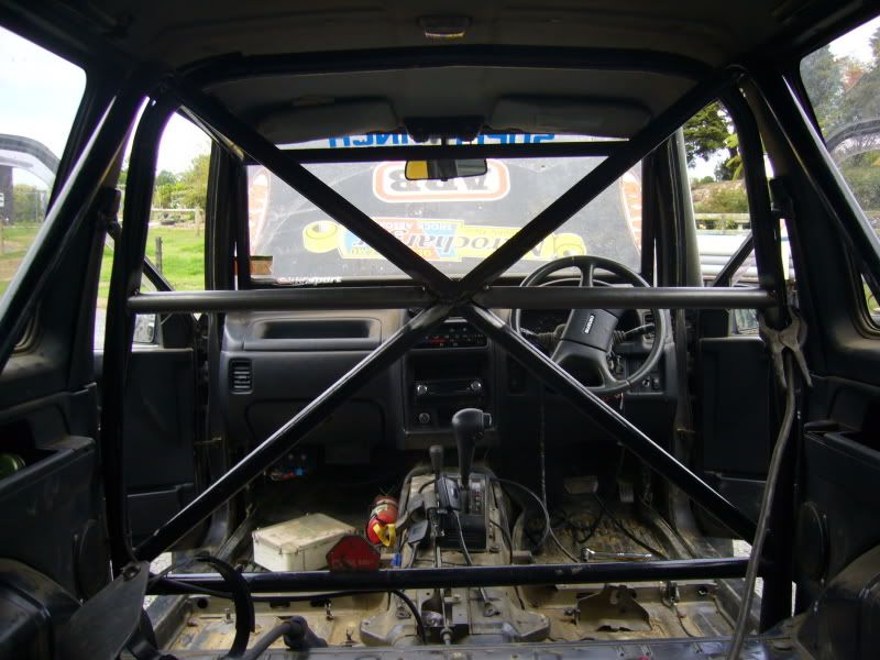

6 Point roll cage

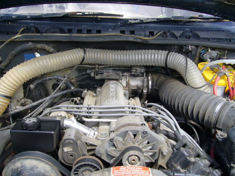

Tight fit into the enigne bay

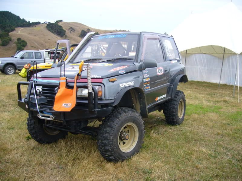

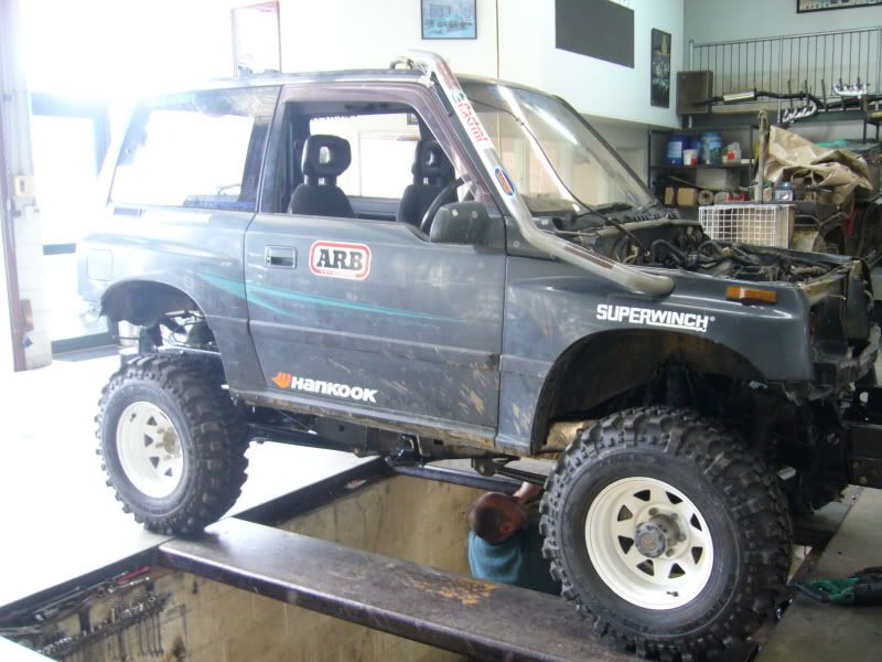

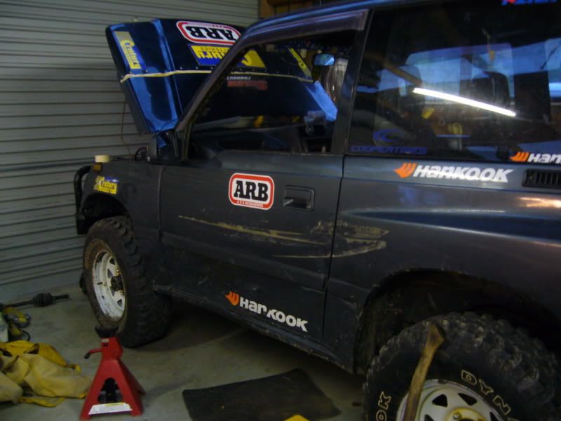

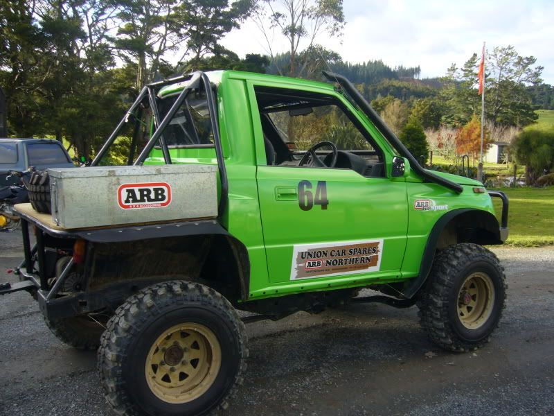

The truck was set and ready for Norwest Winch Challenge 2010
Truck at Norwest

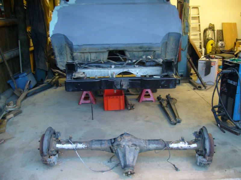

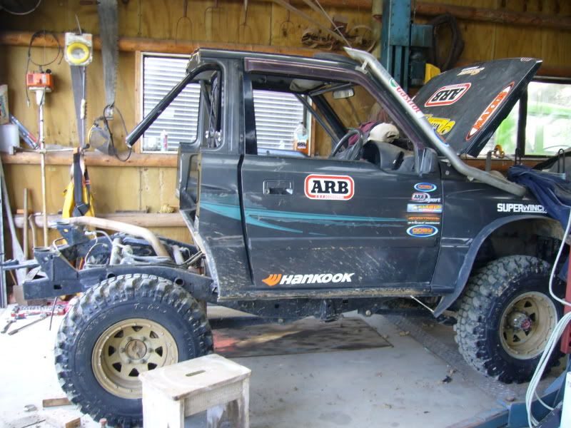

After Norwest WC we wanted to make the truck lighter and quicker. So we chopped it in half and went from there......
Chopped two weeks after Norwest
Chopped in half
Toyota Surf back door was used for the back

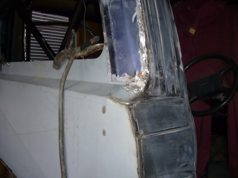

All welded up
Little bit of bogging that needed to be done

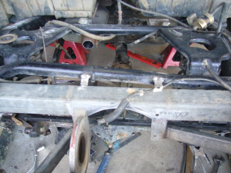

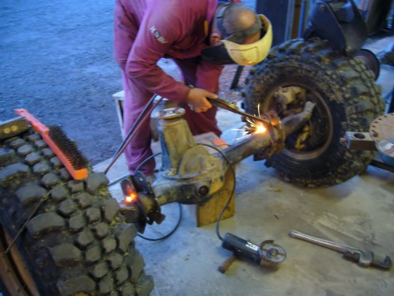

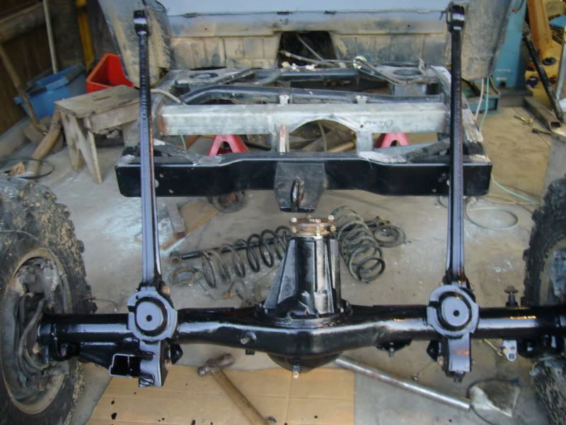

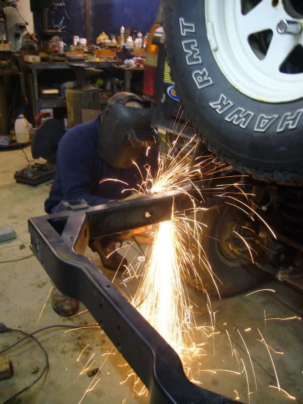

We fitted the later model diff to centre our drive shaft
Mounts being gas cut off the old diff ready for the new diff
New diff
All the new mounts welded to the new diff and painted ready to be fitted.

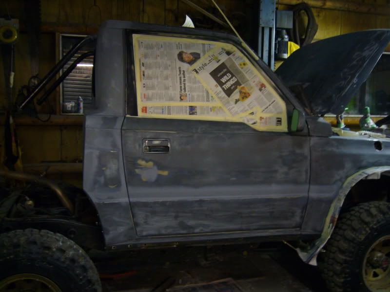

Body sanded ready to be painted

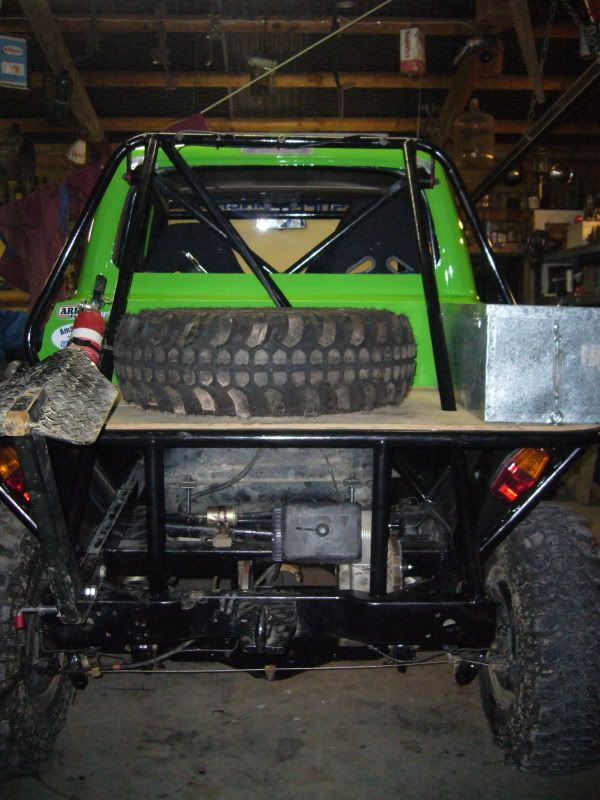

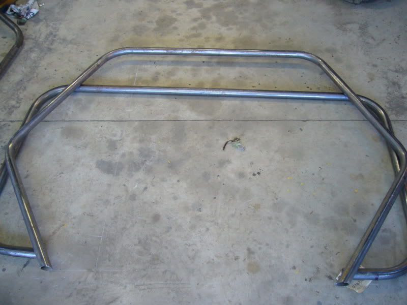

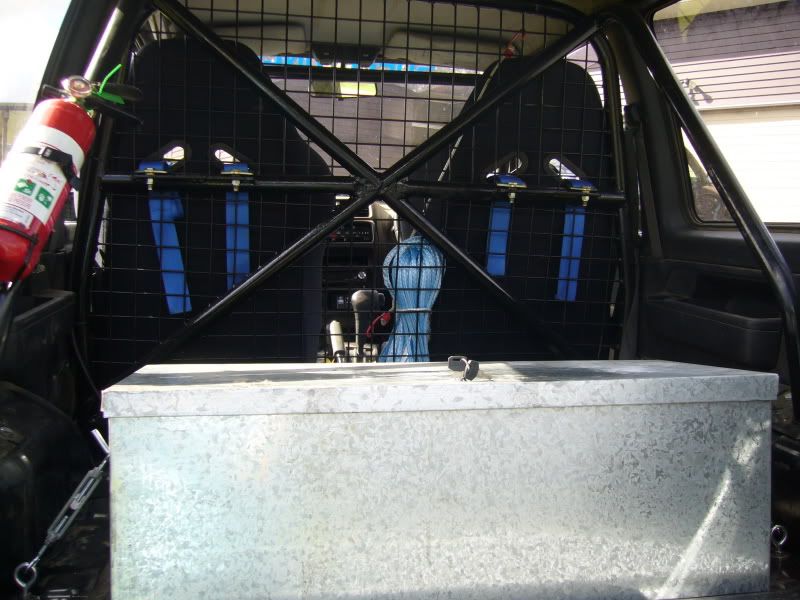

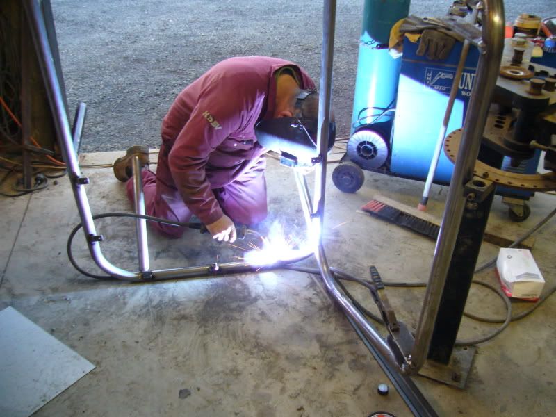

We build the truck with a 6 point body mounted roll cage. The cage had to be changed because of being chopped. The outside hoop and braces were mounted to the chassis. This meant we had to rubber mount the cage to stop it cracking the welds.
Rear hoop of the cage and the top of the tray bent into shape thanks to help from darinz :D
Tray being welded to the rear hoop
Tray layout on the back.

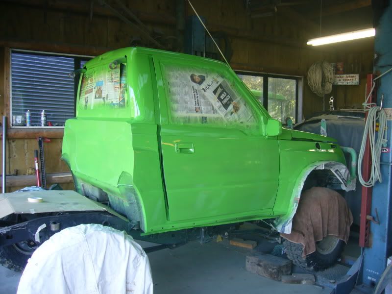

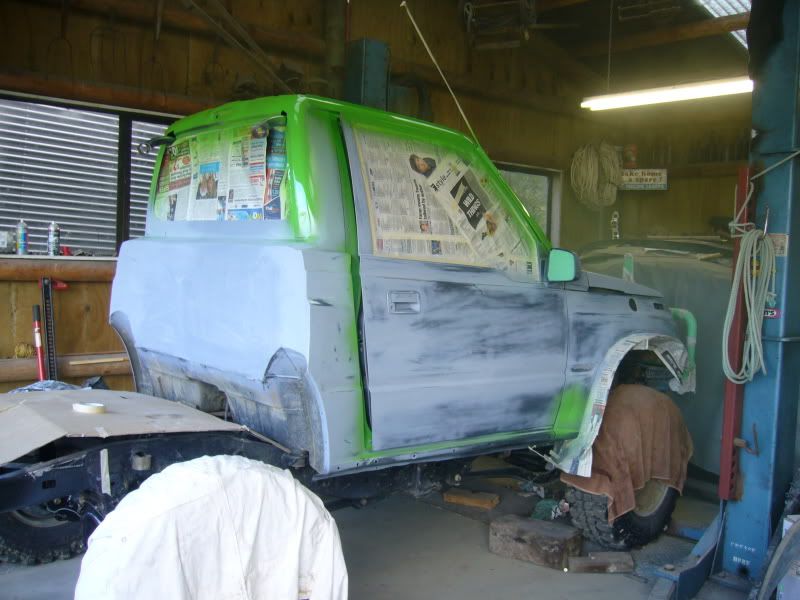

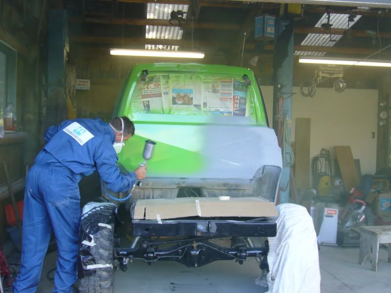

Next was painting the truck and thanks to Carl for painting it for us.
Truck all painted

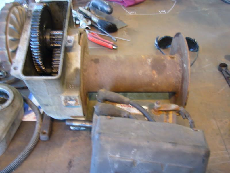

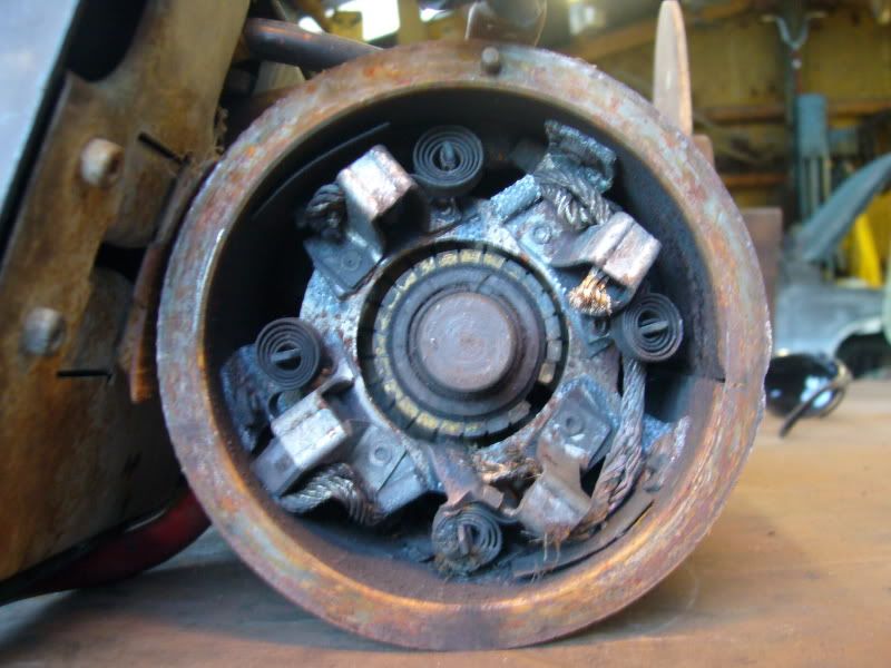

Picked up a cheap Warn 8274 off trademe. Found that it was full of water and the motor was burnt out :roll:
Burnt out motor

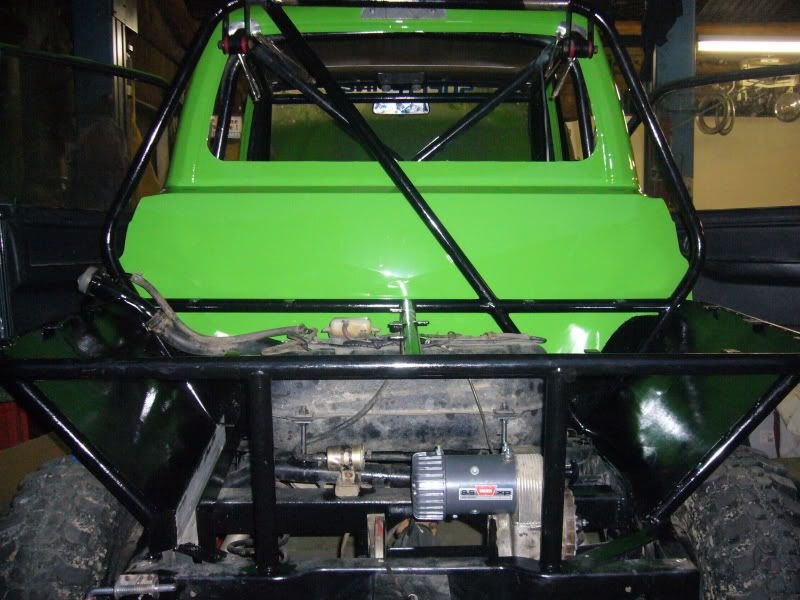

Winch is mounted in the rear of the truck and we have to run a guide up to the front of the truck for the rope.
Mounting plate for the winch

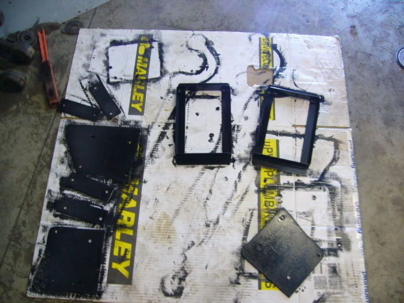

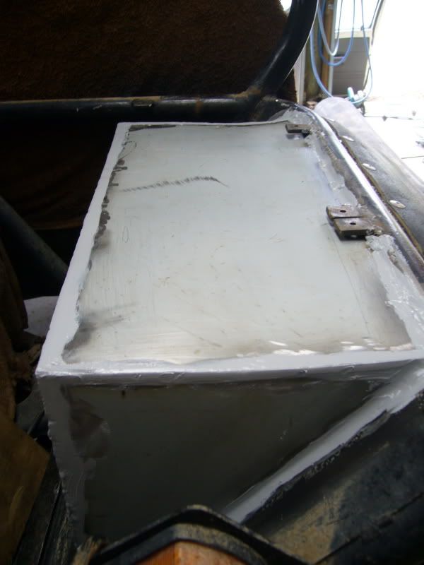

Made new mounting plates for the roll cage now 6mm. Also made plates for the twin batteries.
All painted
The layout of the tray

Tray all painted ready for the ply to be put on top.
Winch mounted with new 6hp 12v Warn winch motor

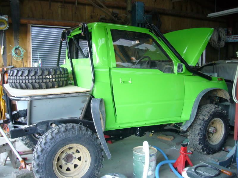

Tray finished. Rear window needs fitting and winch rope needs to be spooled on :D

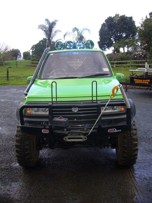

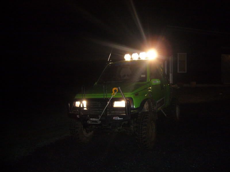

Out of the shed again.
Rear winch rope still not fitted.
Love trademe for the lights :D

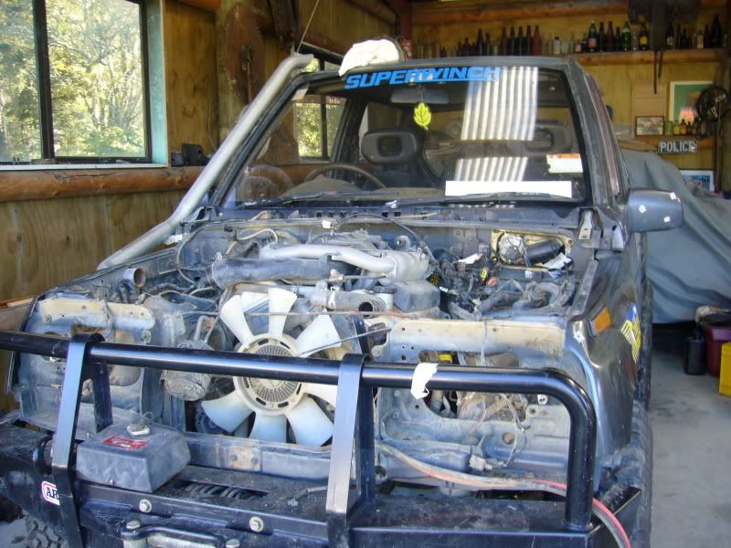

Now, this is where the truck is up to now.

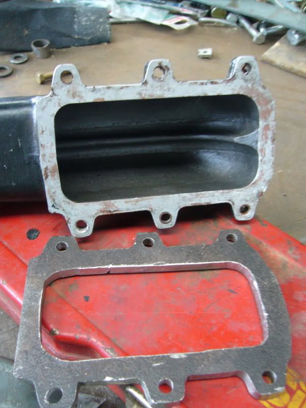

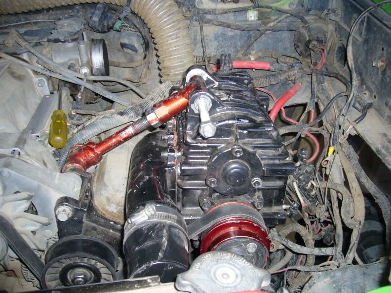

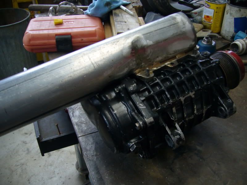

Picked up a super charger kit on trade me a while back after the RWC 2010 and think its time to fit it. It came with everything needed including all the piping, intercooler, BOV, bigger injectors, chip for the computer, map sensor ect... The only problem is that our motor is not in a Commodore any more, so all the piping has to be changed to try and fit into the engine bay :roll: So we need to make up all new gaskets and piping to suit.
New gasket to bolt to the side of the super charger
Old one next to the new one that I made
Its bolded in but need to adjust and alter the mounting brackets, also had to cut the side of the guard.

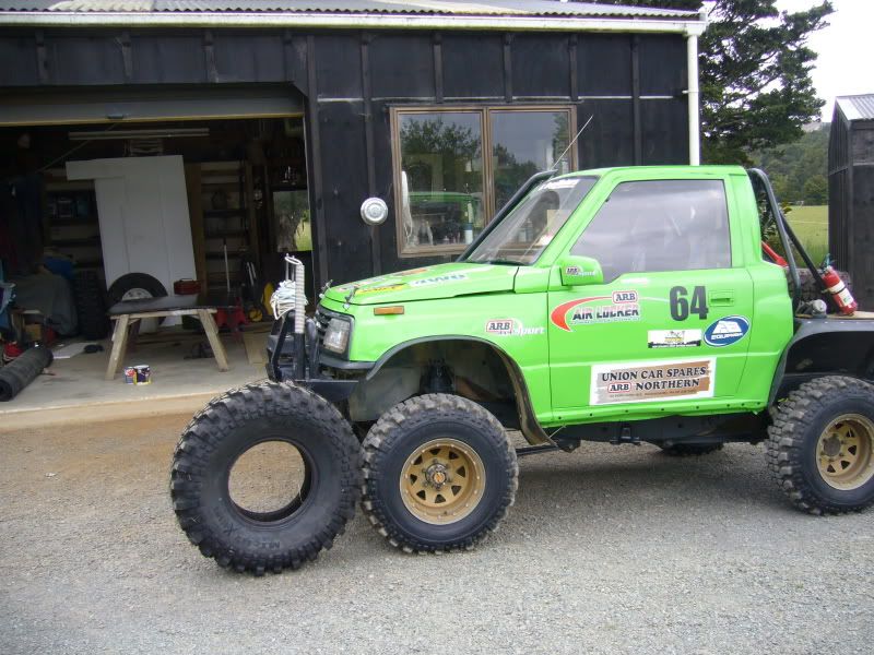

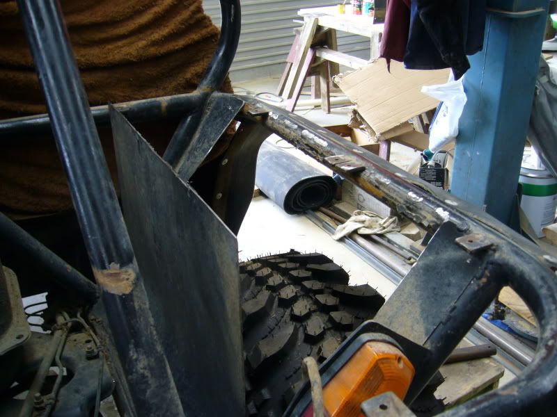

Chopped the rear guards to allow the new tyres to clear.
Card templates made up to get the correct shape for the sheet metal.

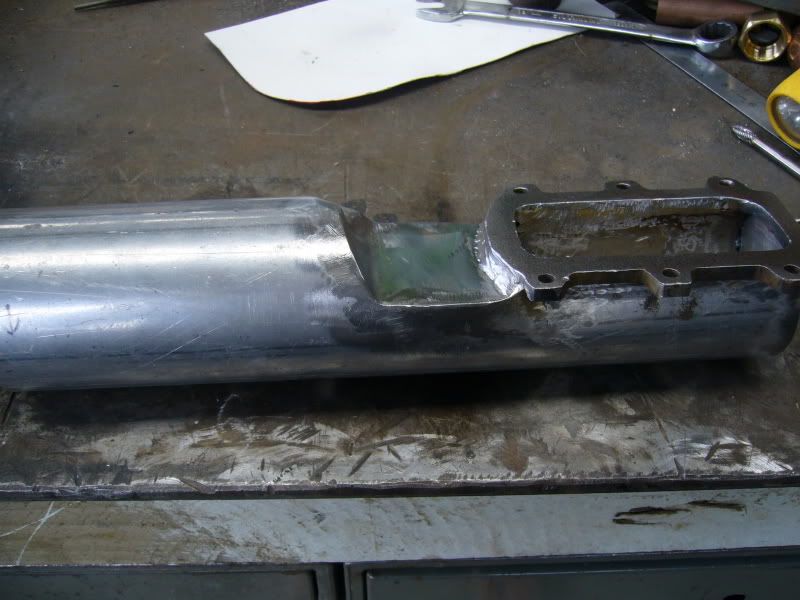

Started this as well. Piping to come off the side of the supercharger to go to the motor.
