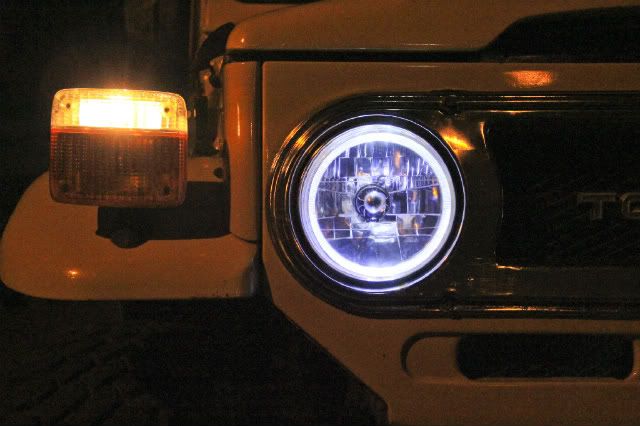

No idea where they come from but these semi sealed units make a big difference to night driving and look pretty bling too with the halo parkers

i have those for my fawdy.. super clear fluorescent lamps.. a bolt in replacement light with changeable mains bulb with fluoro park surround.. oober besterer lighting..

I was just looking at some of those on ebay in aussie they look the same anyway. Just compadible with H4 Globes and the led ring does look rather snazzy. They can come with HID kits would that be the go for the old horse or would it melt things up. Would a 40 series handle hid's?? Its just a farm hack so no worries with wof's or anything just want more light. Are those hid kits a pencil beam though as i would rather a bright spread beam

Beam pattern is hit and miss when you put an HID lamp in a reflector/lens combo made for a halogen lamp. Which is why they're illegal for use on the road. But if it's a farm hack then go for it. Don't worry about heat, the HID lamps produce less heat than standard globes for more light output.
