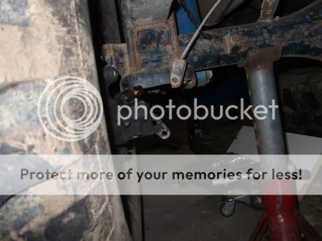

right so im doing this rear disc brake conversion on my lux..
and ive found out that the setup using snr4x4 brackets and mr2 calipers and prado rotors have only been tested mostly on coiled trucks or wide axle converted hiluxes where theres more clearance between springs and hubs, so on my factory leaf sprung rear i cant mount the mr2 calipers up high like i would like.
so heres some pics on the 2 opions I have. what are your opinions? the forward facing option seems best
95% of my wheeling is bush and mud, little rock
and im not using handbrake, ive got a transfer case brake
otherwise is there another caliper i can use thats more slimline that will still work with the snr brackets ive got and the prado rotors
forward facing
forward facing, not bad, the bleed nipple is the most vulerable
rear facing, more overhang
im sure the calipers can handle a bit of a knock at low speed..
i was going to do a u bolt flip but maybe as it is the u bolt plate would help to take some of the shock off the calipers

I would fire the IFS rear axle housing there if I was you to gain a bit more width. There won't be any issues with extra width in the rear (apart from maybe tyre overhang), and IFS axle housing and axles should be real cheap as you don't need the diff head etc.

Dude I don't like it hanging down there. I have seen calipers bashed off with them out the back and right behind the axle, (a decent log strike will do it). You need to get them up high, and you look like you are going to need a wide axle housing for that.
With all the work going into this thing why are you baulking at the axle swap? It is one of the easist mods you can do, (2-3hrs and all done).
If you were in Chch I could even sort you out with a housing and axles, but alas, you are overseas :P

Do the brackets not fit so that the calipers are positioned on top of the axle?
Didn't barbie drive a jeep??

I agree with rok up high is best, you also really need to have your bleed nipples at the top so you can bleed your calipers easy, Can you swap calipers side to side to get a better position for your bleed nipples?

If you are going to keep the calipers at the bottom; could you weld a deflector plate on the bottom of the U bolt plate to protect them?

rokhound wrote:Dude I don't like it hanging down there. I have seen calipers bashed off with them out the back and right behind the axle, (a decent log strike will do it). You need to get them up high, and you look like you are going to need a wide axle housing for that.
well i guess like i said i just want this thing rolling again and want to start ticking things off the list rather than adding to it, maybe i just forget the disc conv for now, bolt the wheels on so its rolling so i can get on with the front end then in the mean time look at 130 housing...
this thing is turning into 1 of those builds that starts off with a little maintenance and rust repair to a full on rebuild... all fun and games though

Fakey wrote:Do the brackets not fit so that the calipers are positioned on top of the axle?
no, calipers hang over the leaf springs

Smurf wrote:I agree with rok up high is best, you also really need to have your bleed nipples at the top so you can bleed your calipers easy, Can you swap calipers side to side to get a better position for your bleed nipples?
yep, by swapping the 2 over it brings things up a lillte higher with the bleed nipple and inlet pointing directly up, i might just do it like this for now, so its operational, then in the mean time source a new housing
