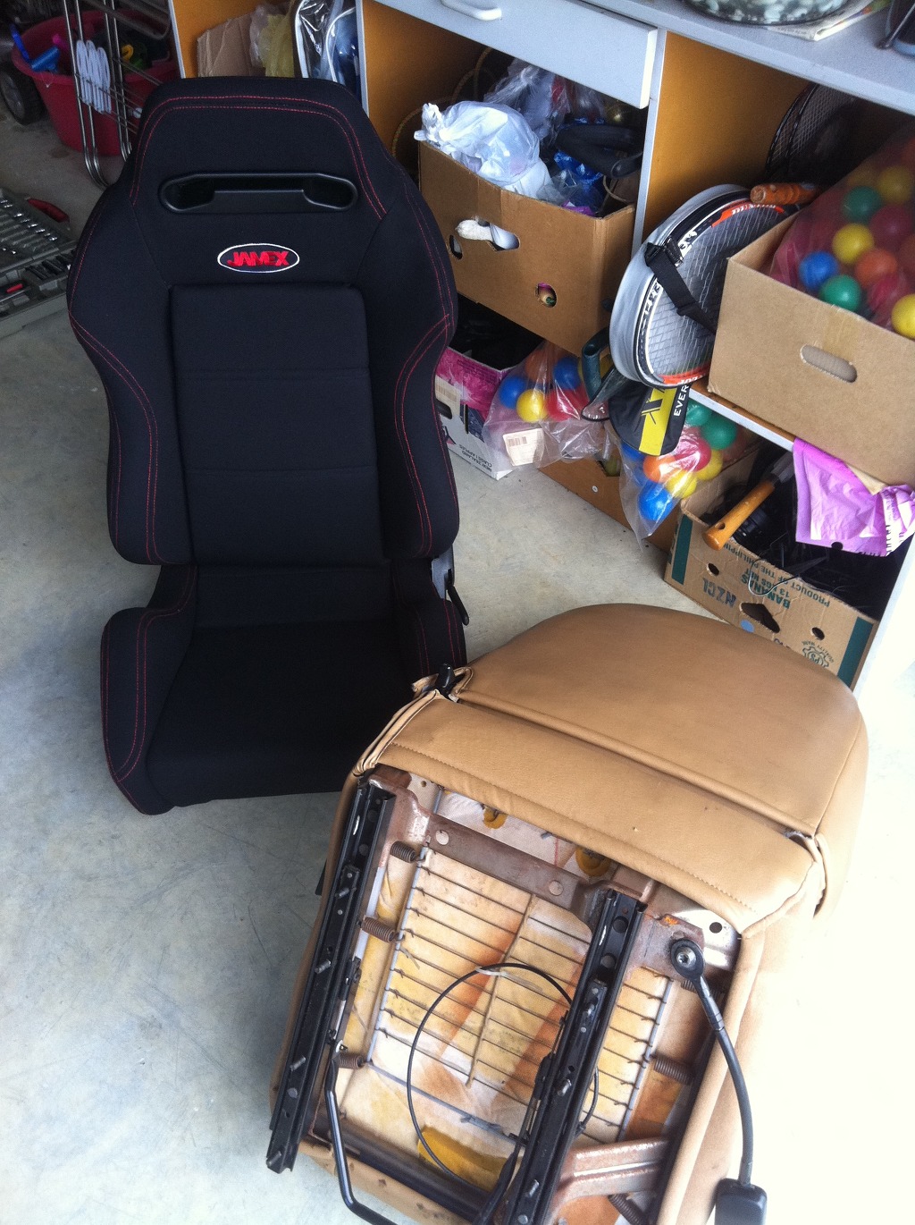

Dan/
Hi mate~
New bucket seats too wide then original seats.
I think need a special bracket ^^
http://cfile2.uf.tistory.com/image/1603934E4DB618C6057022
and I naver been to Woodhill but I really want to go there~

tristan wrote:Dan/
Pop down to your local engineering shop and get a couple of 5-6mm plate strips. You can mount your new seats to the strip and the strip to mounting rails in the correct location.
I have done this to my Discovery and it has come out mint, will get into the garage and take a pic........just incase what I wrote didn't make any sense :mrgreen:

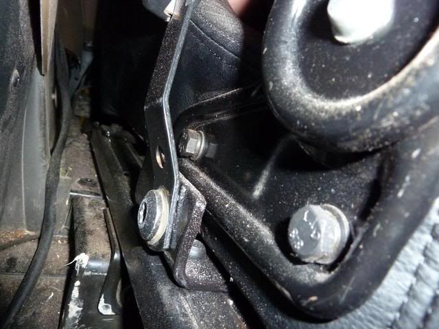

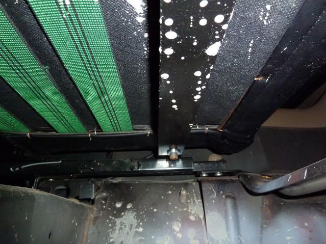

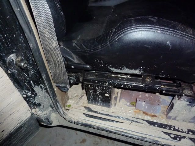

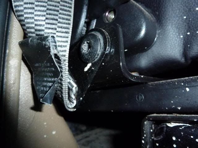

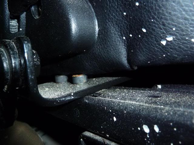

Hi Tristan
When I replaced my OE seats in an old Pajero I had with some new bucket seats, I went in to get a cert for a few mods I had done. The certifier said that as long as I used the original seat rails I did not need to get them certified, but he did them for me so it made the whole lot of mods I did legal. If you change the rails for ones that will fit, you WILL need to get the cert asap.
Here's some of the pics that I have done to my Disco, I had given it a WOF through VTNZ and it passed no problems with the seats the way they are.
Excuse the dirt, the camera adds 10 pounds of dirt for sure :lol: :lol: Doesn't look this dirty in the day time.....damn flash :mrgreen:

Overkill/
Thanks for the photos~
and I really sorry about late replay.
anyway I just refer to the your opinion and photos~~
Thanks~~!
