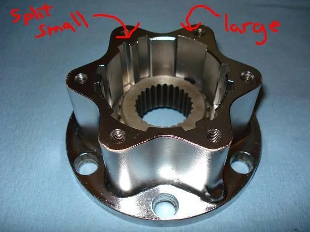

Pop Quiz, why would you do this?
Re: Pop Quiz, why would you do this?
so it won't fully engage making it the weak link???
Do you mean like a fuse Reece.
De-Ranged wrote:so it won't fully engage making it the weak link???

Thats about the only possible answer, hahah.
Or its to weld up a crack hahahahahhahah.
Found this pic on the net (easier than taking one)
Surely it'll still work ok in one of those large grooves indicated where the weld is?
nstacey wrote:Found this pic on the net (easier than taking one)
ah yes thats because the tosser didnt know how to assemble properly and thats the reason why people should have a NZFWDA license before they would be allowed to buy a welder

I reckon you will find that the tag on the spring has broken and that is what is being welded back on. Pretty bogan, but probably did the job as well.
rokhound wrote:I reckon you will find that the tag on the spring has broken and that is what is being welded back on. Pretty bogan, but probably did the job as well.
that makes more sense the tag fits that grove
it does not look like the weld makes it to the spring tho
The weld doesn't touch the spring and from I can see the tab is still there.
My guess is that this guy has experienced taking one of these off in the bush and having it come apart and dropping bits in the mud
I have an additional clue to the mindset of the person. Both hubs were in a tied bread bag, inside a tied shopping bag, smothered in oil
