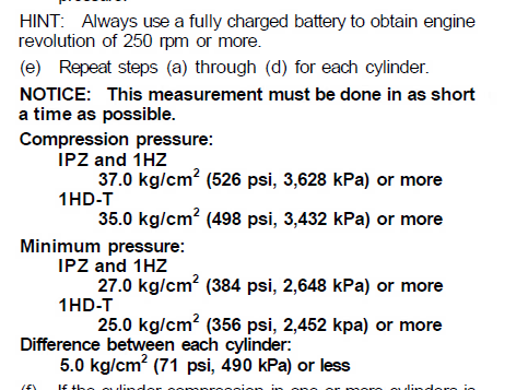

wondered want a compression reading on a 80 series vx diesel should be? and leakdown? what would be a good to ok readings be?

450 and above i think from memory my rebuilt engine was 500....?? something like that with i think 5% variance?

cheers for the help guys esp you bill.
pressy
