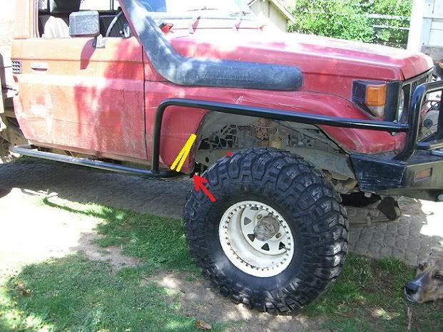

Re: my comment about front bumper position not suiting 50mm body lift.
This is the best photo I have hosted...ignore my dog
You get the idea but can't really tell what the ride height is like:

Slideways wrote:Another thing about a 50mm body lift is that my front bumper lines up with the gaurd nicely and will be a bit stupid being 50mm lower. Maybe I could just fit a 25mm body lift, if available?
yeah I see what you mean about your front bar work, it worked out the oppersite for me coz my ARB bar hung down to low anyway so it made a good improvement to my approadh angle lifting it up 50mm to match the body

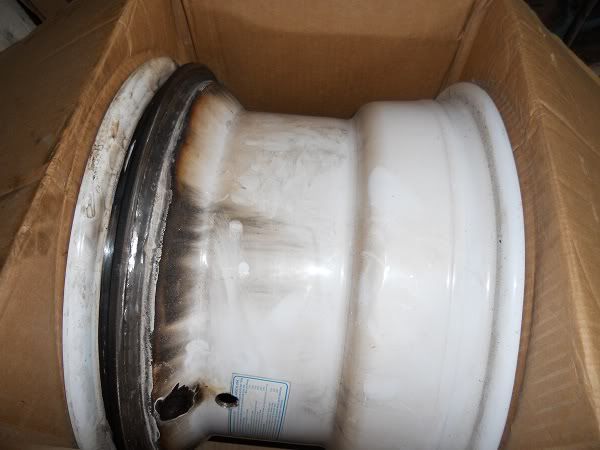

Re: Guard chopping and WOF legality. (LC 70).
um you better disregard that bit about the skinny part of the bead ending up on the outside after you flip them coz I'm talking shit and its already on the outside without being flipped
so if you flip them it'll probably make it harder to knock the outside beads off at lower pressure
Mmmmmm 15x10's..... drool
I'm surprised the paint wasn't damaged too much. I'll still keep an eye out for some 2nd hand though, have 2 from my road tyres, just need 3 more then I'll paint them lime green or something
Will hold out on new since budget shrank after BHG on LC and expensive wof on the daily driver
