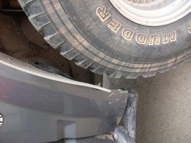

Just put 33's on. that way you get best of both. Even with those you get rub on the factory flares. I've taken them off and replaced with converyor belt. it gives heaps of clearance. This is with sagged factory springs
This is the biggest issue with bigger tyres .35's really rub here.
