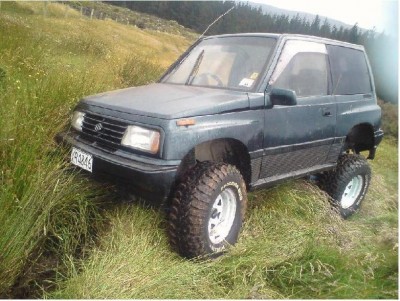

my truck
heres my truck anyways, this is where i got stuck n blew diff
