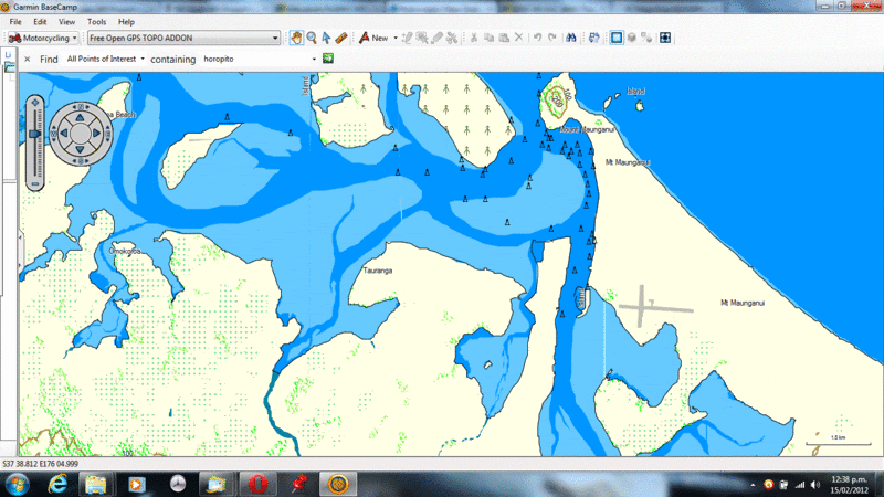

Righto, I have followed those instructions thanks Bill.
I loaded the entire folder contents onto the micro SD card and inserted it into the Nuvi unit.
I don't that it worked though.
How do I change the maps on the GPS unit from the road navigation ones to topo ones.
Also here is a screen shoot of what they look like on Basecamp on my laptop. It doesn't have any roads or much detail as to be usable. Even when I zoom in nothing much shows up.
What am I doing wrong?
Jase.

Re: Help loading topo maps onto Garmin nuvi 1390
it will only show on your GPS and from memory you have to turn the maps on....
Brent's web site is still up and running, though does not look like it has been updated for a while. He definitely exited to soon.
Open GPS forum is full of good info. The trouble I have is it is almost a foreign language. However to update...
I read through the thread on open GPS about downloading topo maps onto a Garmin. They suggested that once the four map files have been amalgamated into one exe file that it be installed into map source. So I installed mapsource and installed the topo map exe file onto my laptop. Then selected and sent the topo maps to my nuvi. I can use the maps now and it auto routes as well. I have still to test it; as I am at overseas at work, I have only been able to run a GPS simulation. All up I have spent a lot of time on this, but I have learnt a lot of what the nuvi can do.
Thanks to all for you help and suggestions, and in particular, thanks wjw for your help. It is people like you that make this forum a success.
Jase.
