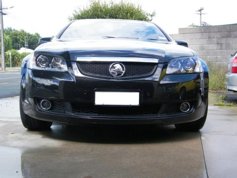

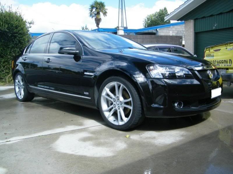

Re: 2001 jeep grand cherokee LTD
no my v8 calais
safaripete wrote:
Great donor engine for a V8 conversion
