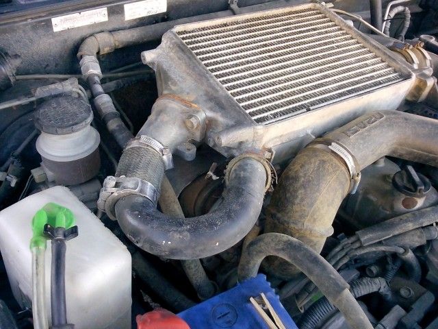

how did you go with rotating the turbo, thought the bighorn and mu's had different turbos, mu turbo's need to be rotated obviously, but i think it has a locating pin. you'll likely nee to do some drilling and tapping.
this was my work around
Re: Turbo Housing.
Hamz wrote:how did you go with rotating the turbo, thought the bighorn and mu's had different turbos, mu turbo's need to be rotated obviously, but i think it has a locating pin. you'll likely nee to do some drilling and tapping.
Hi Hamz,
Thanks for your photo.
I have done nothing so far but I do have all the bits I need to do a turbo swap as I think messing around with the turbo I got on at the moment is alot of work so I got a Bighorn turbo with the adjustable housing all I need to do is swap it over .

hey dude, i looked into it a bit more, and there is a locating screw on the wizard turbo. it's probably easier to use the wizard one, just unbolt the turbo head, rotate it to where you want, and then drill and tap where the locating screw goes. it seems the bolts to get the turbo off is dificult. but yeah, thats what im gonna do.
Re: Turbo Housing.
Hamz wrote:hey dude, i looked into it a bit more, and there is a locating screw on the wizard turbo. it's probably easier to use the wizard one, just unbolt the turbo head, rotate it to where you want, and then drill and tap where the locating screw goes. it seems the bolts to get the turbo off is dificult. but yeah, thats what im gonna do.
Thanks for the info, but I have got it sorted Bighorn turbo housing is easy to rotate loosen about 7 bolts then move to desired position then tighten back up, will be a mission doing the swap but tha's the fun of it.
