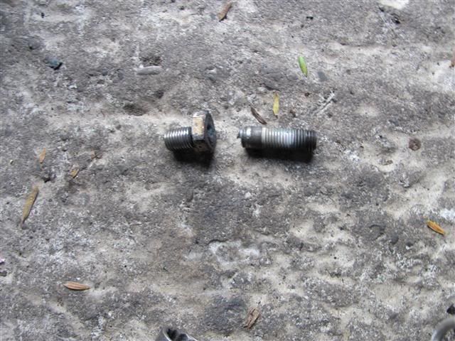

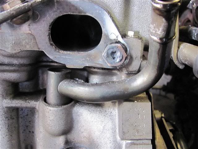

Howto !
Clinton wrote:A wild snapped stud appears:
Clinton uses 'Weld-a-nut' attack.
It's super effective:
To Boon or not to Boon.
