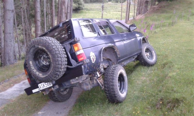

Here you go....
Before swaybars removed:
and now after swaybars removed:

I once worked on a container ship across the pacific, we followed 2 cyclones til one stuck on the cooks and one went out in front, we had roll like you wouldn't believe, those pics look a bit like that!

Great pics though. I don't think my truck in it's current trim would be 'swaying' like that!

far out, thats a great improvement, what shocks have yougot in it?
mine doesnt flex that much, but ive only got 50mm raise shocks in it.

So mine has a 50mm body and 50mm heavy duty spring lift in the rear. I just measured the full travel distance with no shocks in it (making sure the spring remains captured) and then ordered the required shocks with the travel I wanted. Most of the shock manufacturers make a good range, but I found the efs or kyb's had plenty of options to choose from.
