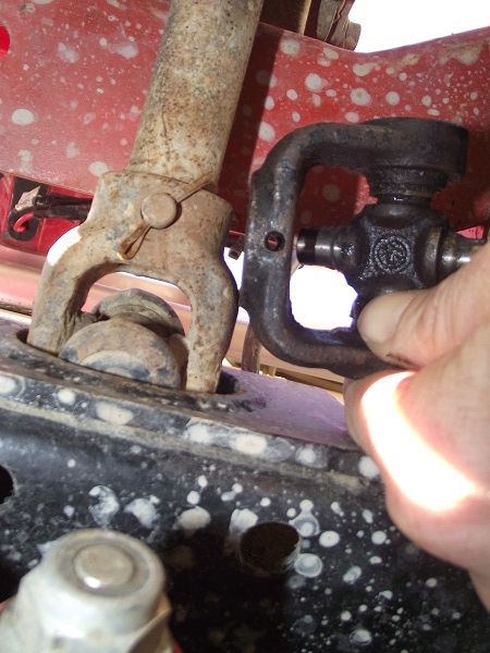

The pic below shows the difference in the shearpin sizes on the couplings (top Saf and bottom cruiser), there isnt enough meat on the cruiser couplings to drill them any bigger without weakening them and they can explode easy enough as they are

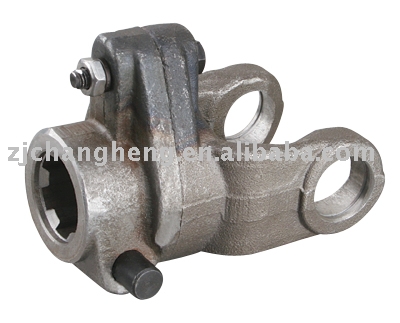

Any considered changing out that yoke for one from a tractor P.T.O shaft? with a shear bolt?

Oh and Crash Bandicoot's tractor pto yolk looks like a sweet idea too.

Crash bandicoot wrote:Any considered changing out that yoke for one from a tractor P.T.O shaft? with a shear bolt?
mate that looks like the business ah

mudlva wrote:Crash bandicoot wrote:Any considered changing out that yoke for one from a tractor P.T.O shaft? with a shear bolt?
yeah they come in all sizes too so shouldn't be too much of an issue to find one to fit, even a second hand one from "farmer joe".
