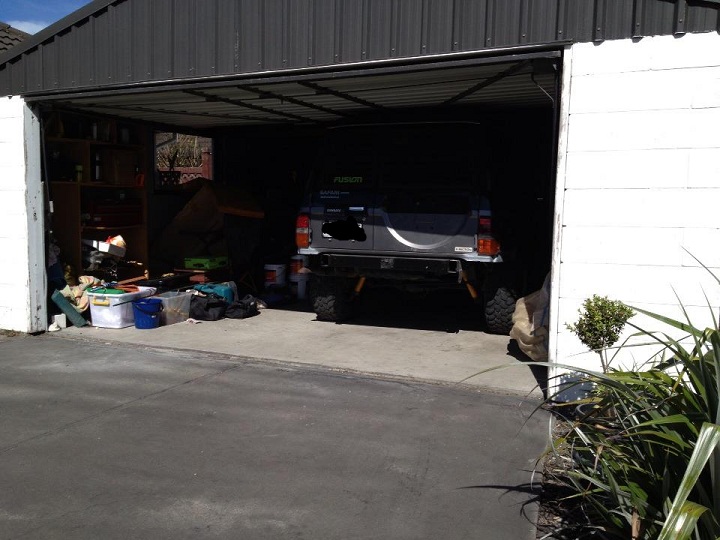

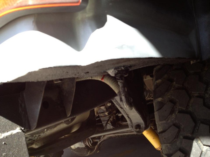

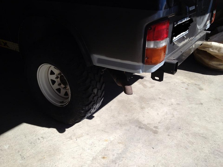

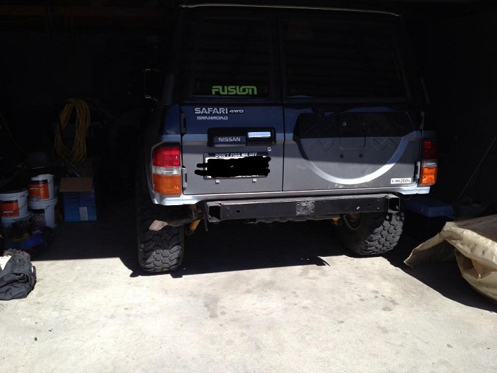

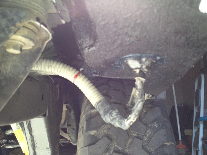

well rears are now cut and welded some 2mm plate under there, looks really tidy actually. got some underseal and slapped that through. couple of offroad trips should make it look old and semi-factory.
roughly 20-25mm come off the body mount not too noticeable with the plate cut and welded to suit and yeah the underseal just hides it all. will post some pics in the next couple of days if anyone's interested in doing this chop on their safari.
also i got in touch with Wayne Martin via his daughter, and he's told her that the cut would require cert, but won't be an issue if it's cut and welded properly (can't see how you would stuff that up anyway).
next thing on the list is getting the rear bumper and rock sliders done. should have these finished in a week or two. got some good ideas what to do now, thanks for all your input guys.
one down fall while i was doing some other bits and pieces on the truck i found huge amounts of rust (right through) on the rain channel, this happened to about 5-6 sections. not pretty at all.
come up with the idea of chopping the sections out and getting mate to fabricate some new pieces to weld in. not having much luck with the roof in terms of rust, can't have had much of a garage life before i got my hands on it.
