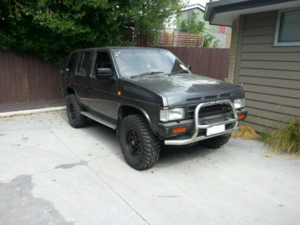

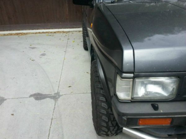

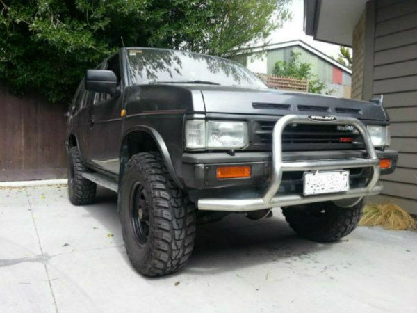

Im running 15x7 +13 offset rims and 31x10.5 tyres and they just keep within the guards

Cheers, nice truck. Those factory plastic rubbers - do they stick out like flares?
Re: WD21 tyre/rim question
lax2wlg wrote:Cheers, nice truck. Those factory plastic rubbers - do they stick out like flares?
cheers, Yeah a little but not alot
