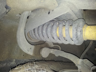

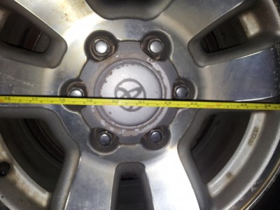

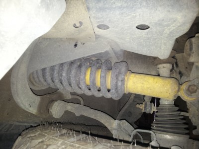

Mine is 530mm from wheel centre to bottom of flare, have you looked underneath at the aarm set up? There is heaps of room..anyway here's some (probably shithouse ) photos

Post by skidmark »
Another.

Post by skidmark »
Lastone.could only attach one at a time
Edit same photo twice...
