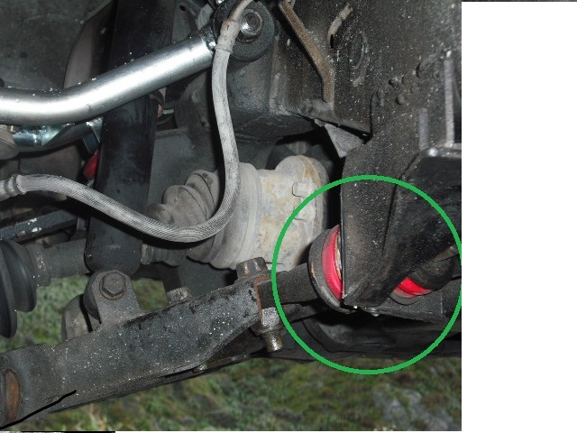

Danielbeek if the steering is vague, compression rod bushings are the first I'd replace as worn ones throw out toe settings.
Yes on the sway bar bushings, before I tore mine out I rebushed it and it made a big difference.
Upper control arm bushings are a decent job, worn bushings will throw out camber settings.
Lower Control arm bushings are hell to place but prevent fore and aft movement of the LCA rather than steering, as such.
Dirtydog I assume you've done all of these, I'm sure you will outline your methods in detail with photos.

I have a secret... I've never had my current truck aligned at a shop...despite redoing the entire front end... it goes round corners faster and tighter than it should, When I get 33s I will man up and get it done.
So theres no confusion this is the bushing that they say makes the biggest overall difference to handling 'goodness'

lax2wlg wrote:I have a secret... I've never had my current truck aligned at a shop...despite redoing the entire front end... it goes round corners faster and tighter than it should, When I get 33s I will man up and get it done.
what about upper control arm bushes? :?
