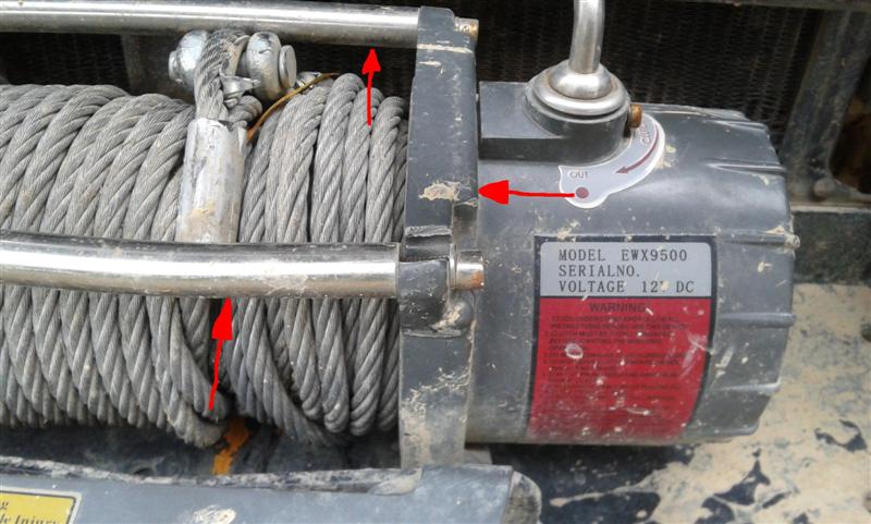

Some of you have have already read my other post. So anyway I ended up stuffing my winch last weekend because all of a sudden it came to life on its own, sitting on the side of a track.
Needless to say nothing was going to stop it winding in....
Anyway, have been performing various tests with Michael from winch.co.nz ,and it appears that the wireless receiver got stuck in the ON (in) position. Upon closer inspection, those receivers are not that great in the elements. Recommendation is to disconnect them from the solenoid all together, or IF you must use them, mount it inside the cab and just extend the cables back to your solenoid.
For me it was bloody handy. Being out on the farm alone each time and being able to bed the landanchor in remotely was great.
Michael being the good lad he is, is now trying to find some parts for me to get mine back up and running.
If anyone has a Runva EWX9500 that can be used for parts, I would appreciate it. I just need :
2 x Tie Bars
1 x gear box casing (Just the part the tie bars bolt to)
Next fun job will be trying to get that cable out.
2 x Tie Bars

get the casiing welded, and press the tie bars striaght.
not a major to sort
Pedro
- Shuttle Queen
- Posts: 672
- Location: Welly
Re: WARNING - Wireless remotes for Winches
Pedro wrote:get the casiing welded, and press the tie bars striaght.
not a major to sort
Pedro
Ahhh my good man. Would this be a service your office can do?
Looks like cast alloy
