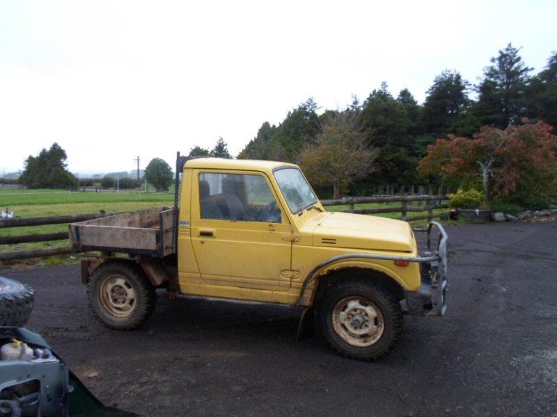

Well I picked this up a couple of weeks ago
After the obligatory doughnuts in the paddock (to test the 4k motor & 5 speed out of course) it has been water blasted and put in the shed. Had a low hanging tow bar that has now been removed.

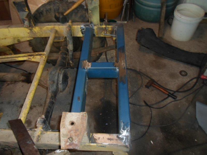

Trimmed the chassis back to the end of the spring mounts, and have welded in some 100X50, the plan is to mount the small winch that was on the front back here along with another battery. My 9500lb will go up front on a new bar.

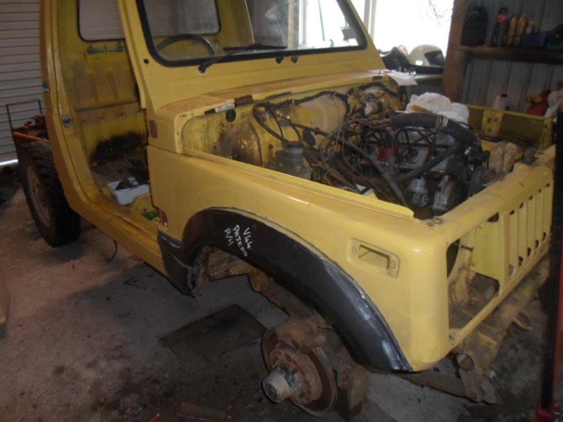

Have also ripped the doors seats etc out as plan on sealing/painting it after fixing the rust in the guards/foot well. Had a measure up at the local wreckers and have decided to stitch some flares out of pajero guards in for a bit of a different look.
