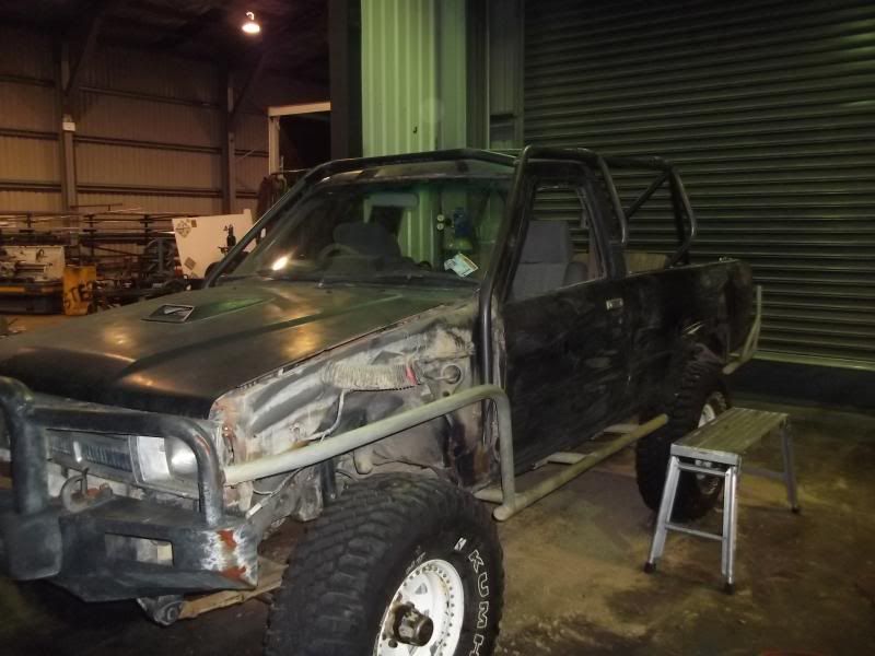

tgaguy1
Posts: 746
Location: Tauranga
Re: wear to mount tow hooks
Post by tgaguy1 »
Here is a pic of mine. I welded a doubler plate on the inside of the bumper which tied into the chassis to bar mounts. Easy access when stuck in the mud.
And here is the same thing on my 80 series.
80cruz
Posts: 21
Joined: Fri Mar 01, 2013 2:20 pm
Post by 80cruz »
looks good that exactly what i need to do, cheers
