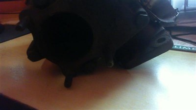

Got a turbo manifold L20ET and Turbo, anyone know if these are a T3 and if the standard oil supply/drain kits will fit? also I need a dump pipe flange

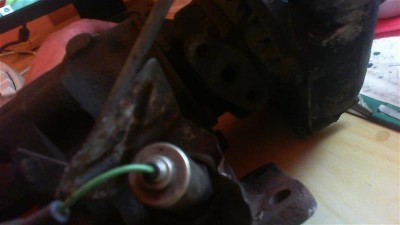

What is the sensor screwed in the first photo? is it O2?
