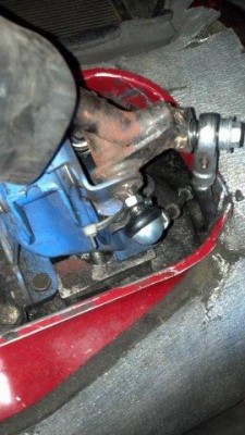

Its deffiantly a five speed nissan with a weird contrapition to take the push pull system and change it into convential gearbox. Will try and get some photo's up of it today.

rcumins wrote:Its deffiantly a five speed nissan with a weird contrapition to take the push pull system and change it into convential gearbox. Will try and get some photo's up of it today.
Sounds interesting, do you mean the gear shift linkages have been modded to go back into a standard gear lever on top? Be interesting to see how it's mated to a transfer box too. Might be easier to deal with getting a s/h box too being Nissan truck, although cabstars are a rare sight, even in truck wreckers.

I will try and attach a photo of the setup below, the transfer case is an LT230 its mated through an adaptor plate from mark's 4wd in aussie.

Wow, clever nut whoever did that
