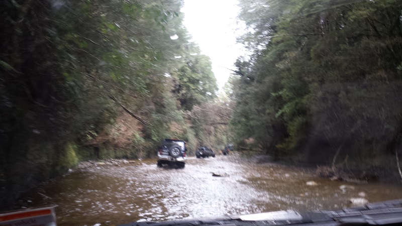

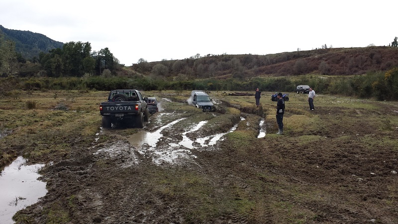

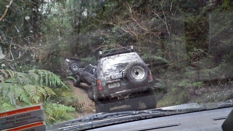

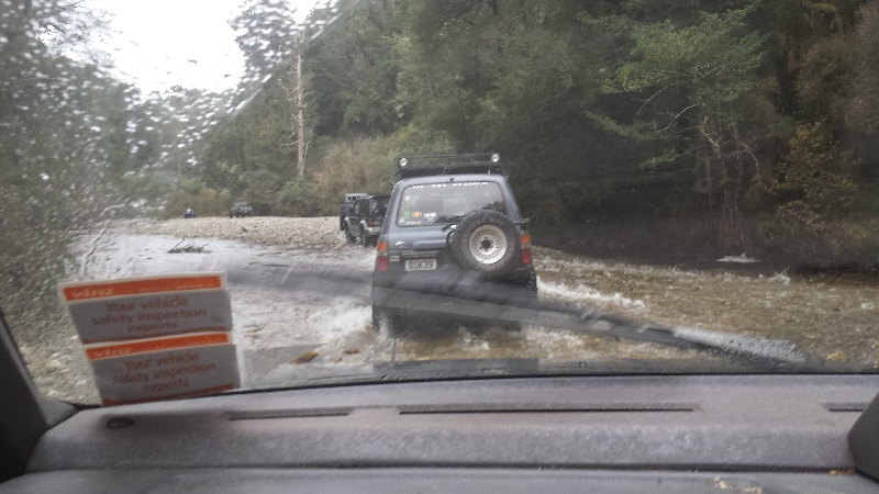

So, I officially have caught the bug after the napolean hill attempt
