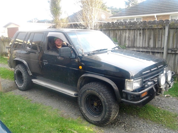

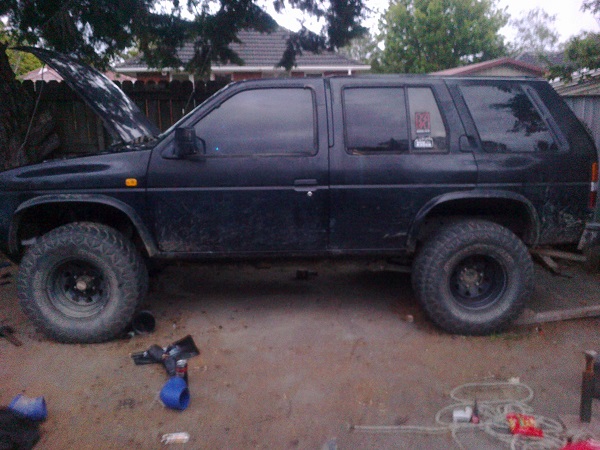

few pics of truck first one befor last all the work last weekend got a load of work done on it
after the weekend worth of work sitting on 33s body lift waterpump cam belt and timing done also attached an k n inline filter and have to fit the 4 inch stainless snorkel
hers when i first got it

Its probably a good idea to upgrade your steering system as it wont last long with 33s and a lot of right foot :lol:

iv got an idler arm brace and got the hilux version of the 2wd steering mod what else would you do to make it algood?

Even with the idler brace mine was eating bushes on 32s. http://www.offroadexpress.co.nz/Forums/viewtopic.php?f=18&t=34450 Steering box idler. Cheap and fairly easy, just make sure you get the size pitman arm as Nissan changed the steering box around 93
