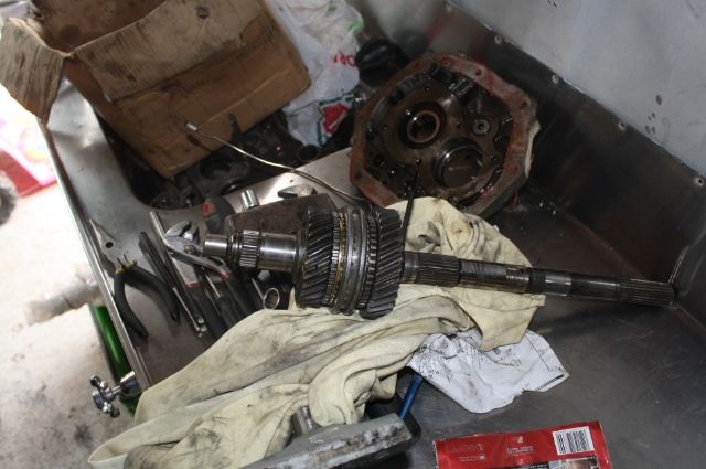

you should start with something like this

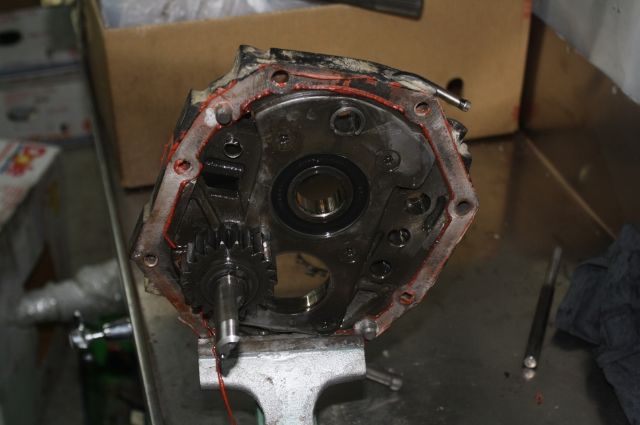

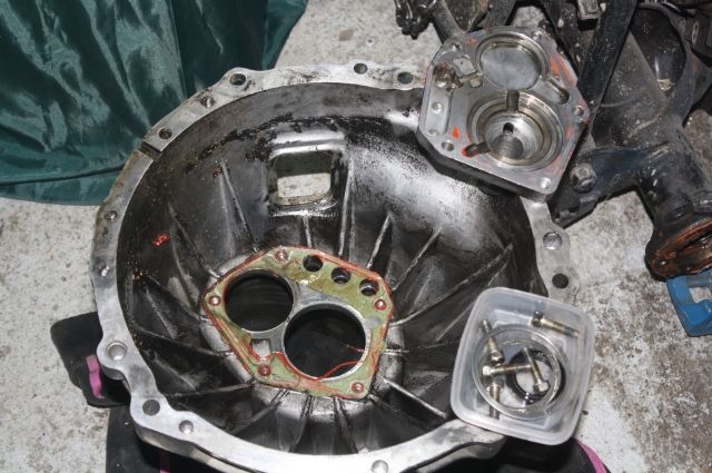

remove these parts and the arse will come off
more bolts etc and bell housings off

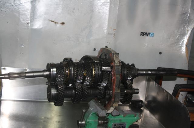

now ur left with the internals, put her in a vice (makes life easy)

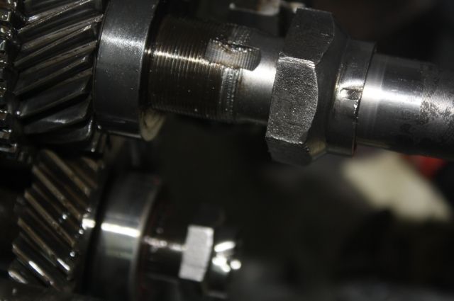

remove lock nuts. NOTE: the big one is left hand thread, which was a bitch to undo cause it was x threaded

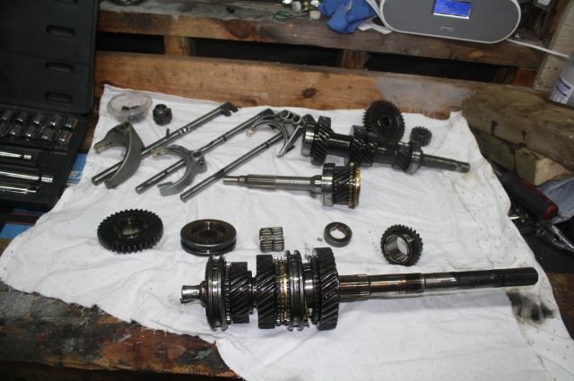

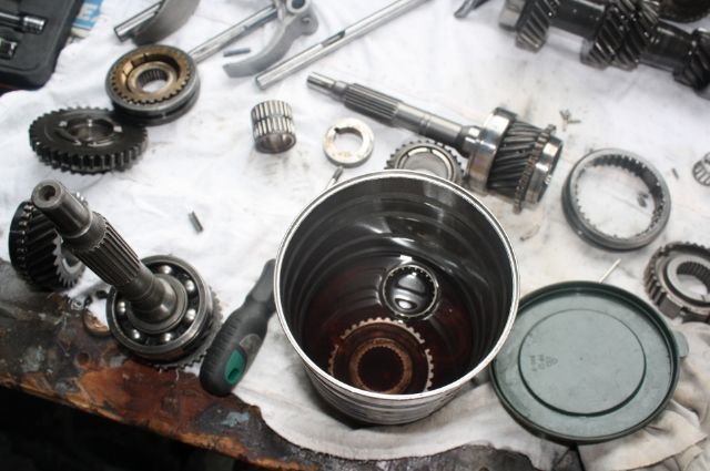

now remove the selctor shafts
then remove all gears and shit off the rear section
put every thing in order so you know which way it goes back on
get your trusty old hammer out and beat the two shafts gently forward till the bottom one comes out (dont drop it)

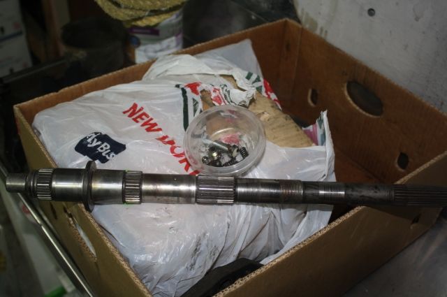

remove input shaft
keep smaken till main shaft comes out
should be left with these internal parts

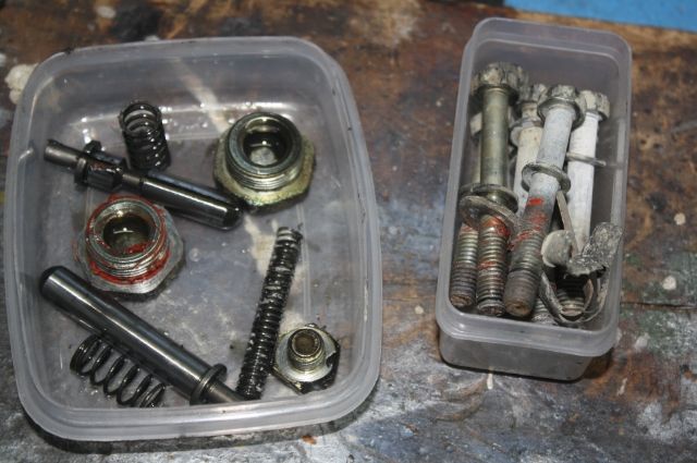

also this

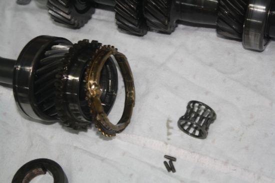

and this is why 4th gear wouldnt ingage
remember to clean parts as you go and reclean when you put it back together

I wonder if that warped synchro ring is the result of running GL5 or GL6 oil, which contains additives that can damage soft metals such as brass or bronze.

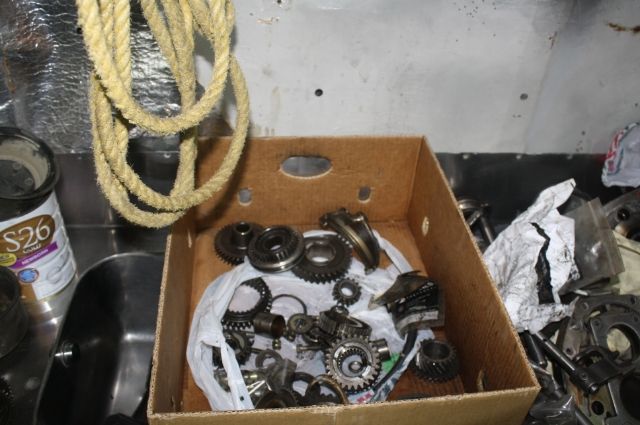

my spare parts box, pm me if ya need anything
