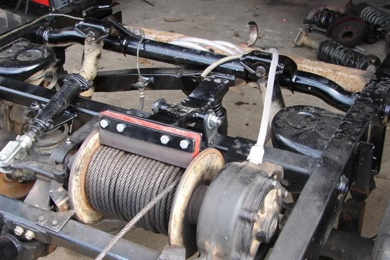

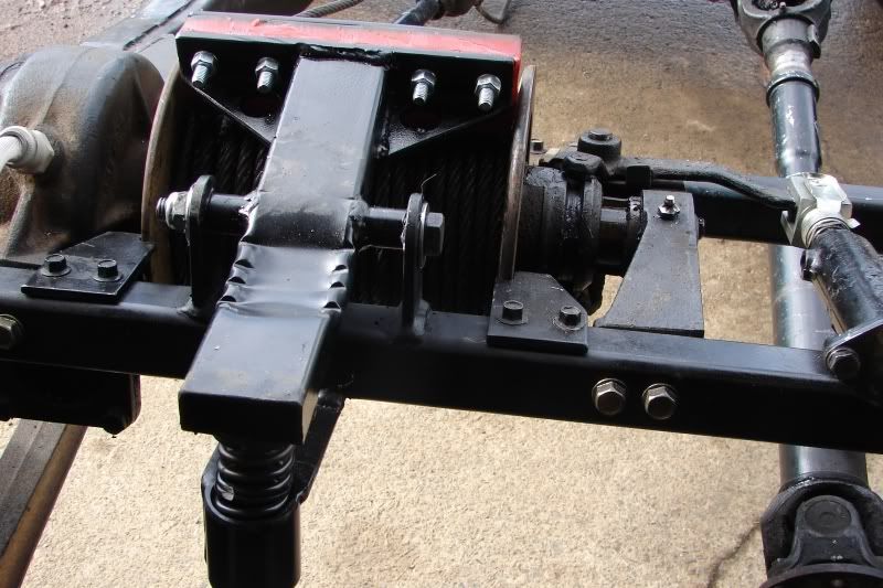

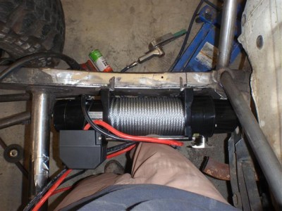

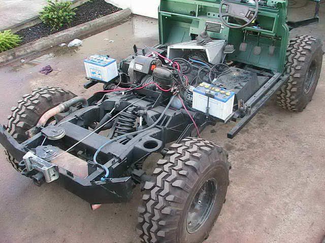

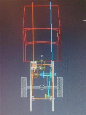

Can anyone give me some details or pictures of their setup?
Particularly
1. Distances from the winch drum to first pulley and how well the winch spools up on its own . ( I have been told 700-800mm is Recommended)
2. Removable rear pulley / fairlead setups.
3. One Pulley or two in the system?
4. Angles of rope deflection, from the pulley to the chassis guides
5. Apart from using sections or lengths of pipe, what else have people used as guides / front haswe
