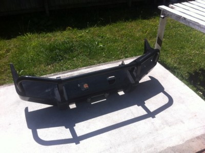

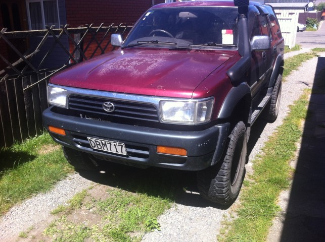

Riccarton, its a 1995 KZN130 surf. The mounts just need to moved 2" higher and the indicators hooked up.

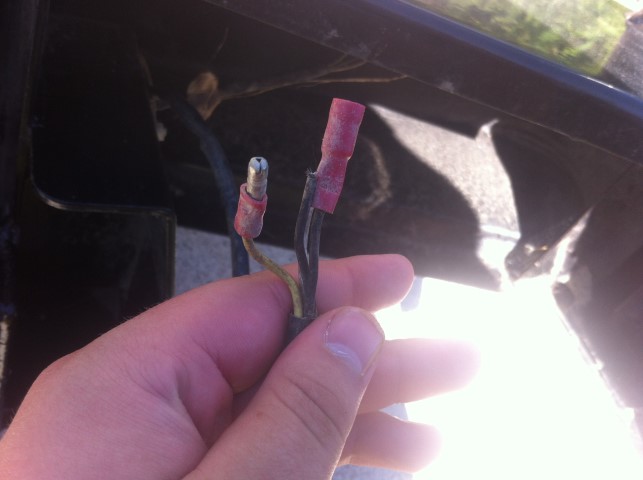

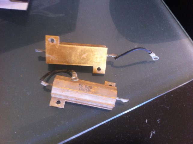

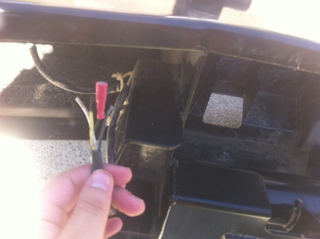

The very last photos is the diod thing that makes indercator flash at correct rate as the indercators in bar are led pretty sure

KIWI_TERRANO wrote:The very last photos is the diod thing that makes indercator flash at correct rate as the indercators in bar are led pretty sure
Rather than installing resisters to make LED flash correct speed you can buy a flasher unit designed to work with LED ... its a direct plug in replacement.
