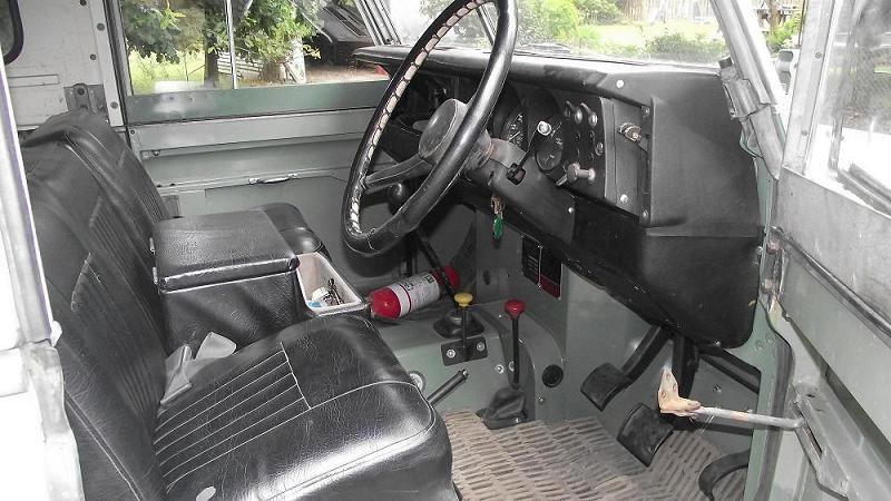

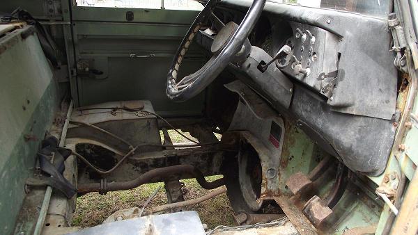

hi there 1st post my name is andy just finnished rebuild on 73 88in running 2.3 petrol from an 85 110 5bearing with the weber 32 34 carb goes sweet had all the usual bulkhead rust .was parked up for 13 years and needed all brakes rebuilt no major chassie rot has just passed wof with no worries. has anyone tried the 3.54 diffs from rrc or pre 93 disco in a series? my motor is srong wont have any worries with grunt but would the step up to higher ratios make drivabilty worse ,its pulling about 3200 rpm at 85 kmh. cheers Andy

ive got round to fitting the 3.54 diff head in the back still trying to track down another for the front , its transformed the old girl . engine has plenty of tourqe to pull it running 2500 rpm at 80 kmh, 1st low still slow havent tried off road yet
