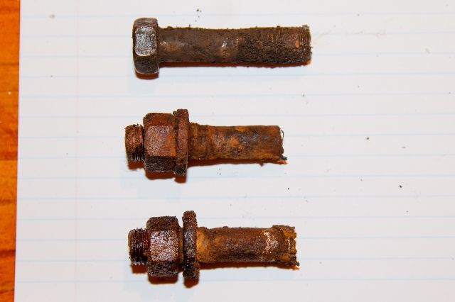

Sorry to rehash this topic but the video above prompted a bit of maintenance of my own recovery points
My front hooks have been on there for 4+ years
3 of the 4 bolts were rusty as, the one in the centre is heavily compromised, all had to be removed with a grinder.
It's not hard to imagine these little time bombs hiding on trucks all over the country, waiting for an aggressive recovery to unleash havoc.
Check your recovery gear and have a safe weekend!
