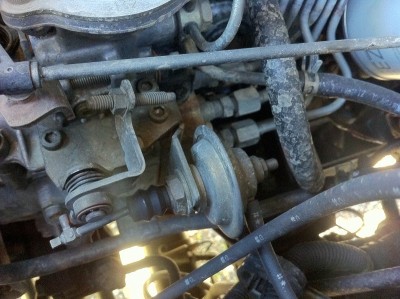

Re: Low revs at cold start
The diaphragm unit in your pic is the vacuum operated idle-up device which should actuate when you switch the aircon on. The waxstat unit should be on the side of the injector pump underneath the diaphragm unit. Hard to tell from your pic if it has been removed or not. It should have 2 water pipes going to it. If it has been taken off and a plate put on then yes you are going to have this problem with a slow cold idle.
as he said above , there is a possibility if you have fucked with your fuel screw etc the idle up for the aircon needs adjusting to suit ,
