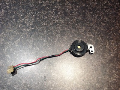

Thought I would show anyone interested in removing these little bastards

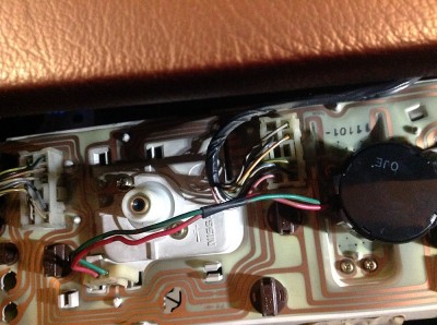

You will need to pull out you speedometer to access the alarm.
it has a red and green wire going from a plug to the alarm, simply remove the connector and you can speed in peace.
hope the uploads work.
