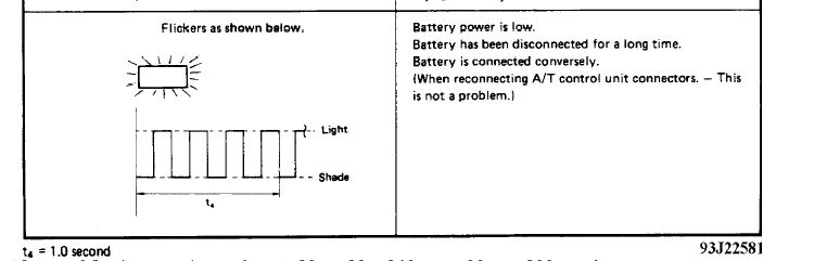

The A/T Check lamp flashes 16 times , not sure what it means?
