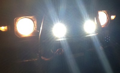

Spotlights fitted. Bolted on the aluminium CRV nudge bar and bolted lights on to that. I can hear you all going; "What, a CRV nudge bar, on a cruiser, ugly..."
Lights bolted to that. Had a look in the engine bay, RH head light had a two pin plug hanging off it, tapped into the common and high beam leads off the H4 plug. So duplicated that on the LH side and sorted.
Next step will be a switch that will let me have high beam without the spotlights... And perhaps one that allows me to just have the spots with nothing else...
Pic(s) to follow...
Pic(s) to follow...
